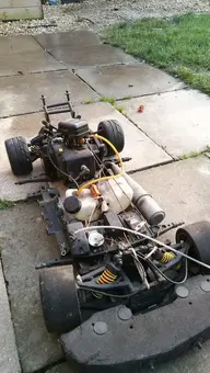

So I've picked up my old FG 1/5th scale that was bought in 2002/2003 from my dad. It's not been raced or started in over a decade.
I don't have a clue what the model is or what it's likely worth. I've just measured the wheelbase and it looks like it's 530. It's pretty stock apart from cable discs on the front.
The exhaust is hanging off and there's no bolts so I need to replace that.
I need to order a new battery pack as well as the old one on there (if it works) is unsafe to use.
So essentially I need some recommendations. Going to get it up and running and clean it up to use again. The shell on it is the old Mercedes DTM CLK.
Anyone with any expertise able to give me advice on what model I have so I can easy trawl for spare bits?
Much love!

Got it running. M5 26mm bolts to mount the exhaust to the engine. Gave it a good bit of degreasing. All parts look like they're moving, just a little bit of rust here and there.
Now going to order a battery pack and some clips for the shell.
If anyone knows of what shells I can buy to replace please let me know :)

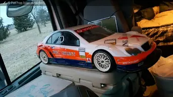

xlamontx
93
Likes
5
Memphis, TN
#20
You may not be able to see from the pictures, but those are not stickers on the outside of the shell. It's all painted, or appears to be, from the inside. Its not perfect, but someone did an exceptional job.
