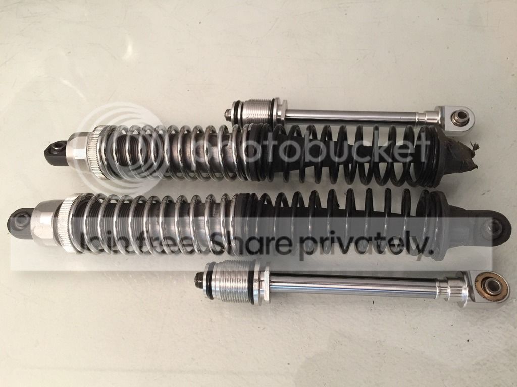

Baja shock mounted on my rig 215mm

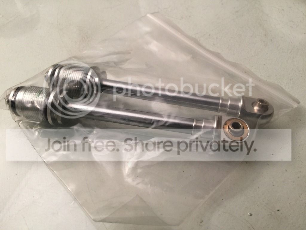

Rovan part I bought (10 mm thick shaft) Update: correction 8mm
oh yeah, best deal out there! those are 10mm or 8mm ? only kits i have seen are 8mm.
i have went through a bunch of bent shock ends , surprisingly they hang on for a while i would run them bent for months, but the rovan rebuild on the HPI stuff is good solution.

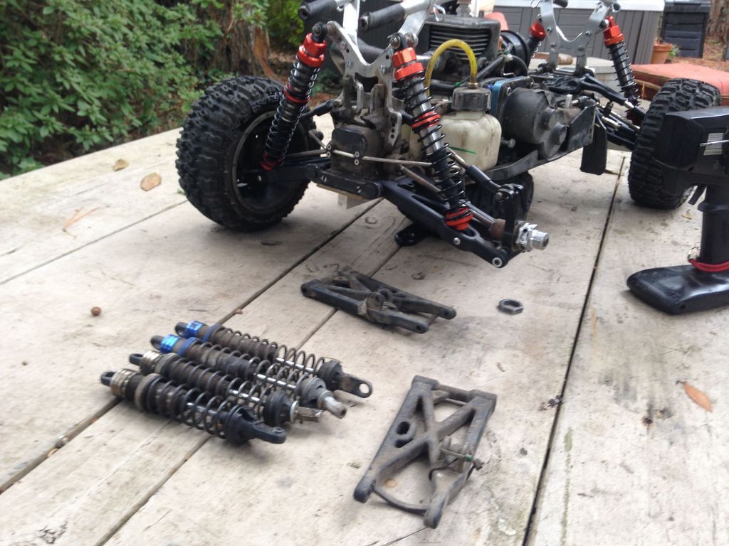

heres a look at XB, MT, and HPI. hpi are on the unit, with MT lowers arms... so it may give some insight in the jump over. aslo some pics of stand of on
project thread.
hpi definitely right direction esp. with bigger shaft kits
The DR shocks have 195mm off the car, I'll also measure them on car. Do the shocks posted by designed2survive mount on the lower arm of the DR? I don't see the end, the part that got bent on mine.

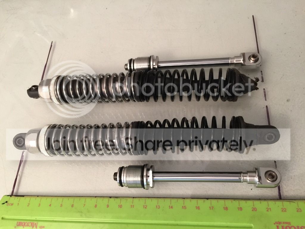

Don't know what you're referring to but may be this can help. 220mm fully extended (off the car). Upper bolt center to lower bolt center 215mm.
Yeah, the DR shocks are about 25mm shorter... too much difference? :( And it sucks that these also have the lower part made of plastic, which is the part that failed on me...
25mm longer shocks are not a problem.
Yes the stock HPI shock comes with the plastic shock end with 6mm shaft diameter. They can last long. When they fail most people get the aluminum replacement parts as an upgrade.
You will need to buy a pair of HPI or clone shocks. Run it like that and if the shock end fails, replace with the aluminum shaft rebuild kit.
- stock clone shock rear Rovan $40 / KM $50
- aluminum shaft rebuild kit 6mm $18 / 8mm $30

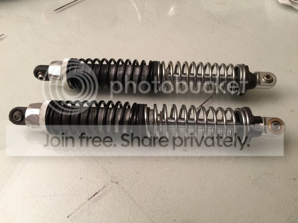

On a different note I haven't tried the shocks yet but they do look beefy and cool.In case you wanna go this route
Those definetely look beefy as hell, I'm gonna go this route if my new shocks get bent as well.

The remaining weak point are those plastic spring retainers at the bottom end. Will run them like that and if they fail next order will be the aluminum ones.
