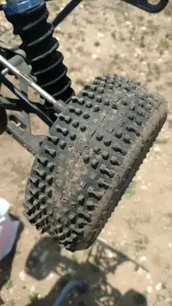

Need to tape them tires
What make tire are they?
MadMax pins
I had a set ran them a couple times.....wasn't impressed sold them the giant grips are still the best
That looks like random knobby chunking from a defective tire. Rare occurance, but I have seen this on MX bike tires.
How much preload do you have in your springs?
I found my truck handles better with softer suspension, so it sits just below level at the rear, any higher and it felt unstable and was bouncing over the bumps rather than soaking them up.Rear is about 1" worth of preload, just enough to keep it a tadd higher than level. Front is like 1/2" or less and sits level. Which I wanted to start the front lower than rear and tweek it as needed. I'll have to speak with others but I think it's more track surface related, lot's of rocks and waves. I can see how going over a set of waves/humps diagonally could do this especially if there's a patch of rocks there. I'm gonna tape just the tires and report back next Sunday.
