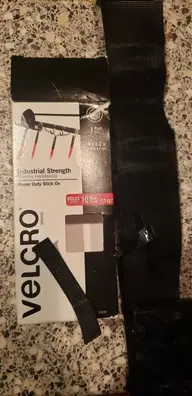

But also wanted to add that I could not get the supplied velcro to stick to my brand new zen 320 for the crank outerwears. I had to abort that one. But my next motor I'll def try that job again! We all run in grass and need that gear!
I kind of have a thing for keeping hook and loop (Velcro) on hand for quick fixes. I got this at Home Depot:sticky.webp
Super cheap and you can cut it to whatever thickness and length you need. Try scuffing your case with some 220 grit sandpaper or a scotchbrite pad and clean with alcohol or carb cleaner, then sticking this stuff on it. Should work like gangbusters.

Really rad my man, I'm excited to find this rad velcro and try it!
