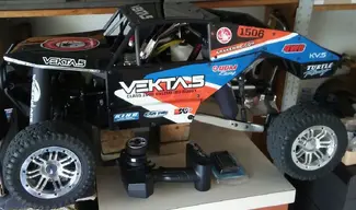

Yep, did the same until my pullstart bolt came loose and destroyed my flywheel, waiting on parts to come in tomorrow to get back up and running....hopefully....I run three heat cycles = run motor slow never go past half throttle for ten minutes than stop the motor for ten minutes for cool down, go though three tanks of gas using Castor 927 replace spark plug than switch to Motul 800 and run at full throttle for short runs keeping it on the rich side. Works for me, everyone has a different way to break in new motors.
