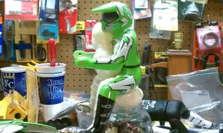

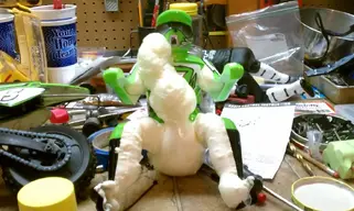

A bit of thread hijacking, but.........So, I have had my DX450 motorcycle for about a year now. The lexan rider is a bit hollow...actually, he is really hollow. Since he has lost most of his screws and he is getting flimsy, I saw that filling all the hollow parts with that spray insulation foam stuff works great. I bought some and decided to fill him this afternoon in between other things.
It worked great. I made sure everything was cleaned up so the foam would "harden" correctly.
I went out in the garage a few hours later to fetch a screwdriver for something else.
This is what I found :eek::
The window foam will not get as hard but will not expand as hard. It will also be real easy clean up. May not work in your situation since you are using it to glue your rider back together?
haha yup, I did that. now when you cut it off you'll find the rider very stiff (looks like he has a stiffy now LOL) but then I found the feet got broken off on wipe outs... the flex is not a bad thing. finding a balance of fill and flex is what should work best
Pipe- you are the only one that seems to get it. :lol::lol::lol:
