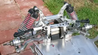

well i got the alloy rear end in, had to tweak the 4mm sway bar alittle to get it to miss the dog bones.
the rubber drive shaft boots will not fit on the diff side, im not willing yet to dremel the new lower suspention arm braces to make it fit ill do that once ive used them for a bit.
im going to have to get some alloy m8 ball ends for the turn buckles ive added them to the still need list.
any way heres some more pictures lols

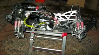

after to days effort im reasonaly happy ive done a mock set up install and all its well just needs a couple of tweeks and then im on to the hydros and the engine install
a while ago i found some hi flow fuel lines in the bottom of a draw in the shed left from my baja, i sold it befor i got to put them on, so i thought ill give it a go and put them on the new fg fuel tank, as the fuel line was squished a bit int he fuel tank gromet and this line will work better with me fuel line clips for my rollcage, with a bit of modding there alright.

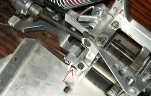

one problem ive got but can be fixed with a grinder, (not to keen to grind new parts with a grinder)
im using a 16 tooth layshaft gear on mine and the dps rear lower suspention arms are in the way of the fg small alloy engine mount big time there no way it will fit looks like ill have to grind some off (ouch)
this is what im talking about
i don't think the 14 tooth would even come close
yeah easy fixed, i will gring the lower supention arms head where the pin goes thru as it looks like it has more meat, i marked it out today looks like only a tad needs to come off

any way the problem i had today with the dps rear lower alloy suspention arms and the fg alloy small engine mount not fitting corectly, is no biggy, i have to file this section down only a small amount it should affect strenght of the arms or truck.
this is the bit and the amount im talking about.

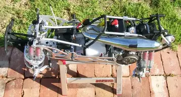

well ive finshed the power station, new g260rc with ported head, replaced the new 603 carb with a new 668 carb, and added ada billet manifold and the ddm top end pipe, tps chbs alloy gear plate, cat5 steel gears, stock fg airfilter and for now a stock zen clutch with a 8000rpm spring ive just got to let it sit for a couple of days, for it to dry.
some more pic,s almost finshed just need some susenion tweaks,modify the front turn buckels, lower the wheelie bar, rest the radio and install the brake and throttle linkages, then send the body and rollcage off so i cant drive it :(
here are some better pictures taken during the day
