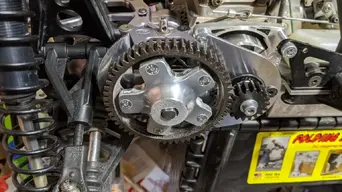

$$@%$&%^&^%(*& Rovan damn it. So the layshaft is the thickness of a "C" clip to short to install the "C" clip. Tried sanding the spur gear carrier but i need to take more off . It will be easier to spot face it on the mill . Unreal . So damn close to having it all back together. View attachment 62357
??? setup looks ? through ??
Thanks, tell me about it . If I take the washer out that was supplied with the carrier there is to much slop that would allow the gear to walk back and forth on the layshaft . It would probably pop the clip off. I still need to worry about the clip coming off. I just don't want to make it easier for it to come off. If I start loosing c-clips it will force me to buy Layshaft with the bolt that goes in the end of it to hold the spur gear. Think its TI. If I have to buy a new layshaft it will become a winter project and I'll need to buy a new carrieer too because I modified this one to fit. :poop::ROFLMAO::ROFLMAO::ROFLMAO:
Clipless layshaft and you won't have this bullshit ?? $40 off ddm, one of the best things I've bought ?. But sand the spacer down cuz you need to run that thing ?
Yeah put a big file on the carrier ?? I went to the hardware and bought harden e clips the other day?? a lot tougher than the stock ones??
