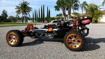

heres a couple of mine.
heres my First Release 06 RTR.
Meet MEAN GREEN. Mean just got his GH Front lower A arms tattood (anodized) Green yesterday. hes almost done. some new duds and he'll be Stylin and Profilin.
and heres the beggining of the new Themed Baja Build.
this one will be Seeing alot of finger time in the next month or so.
you ll be able to follow the build on HBF, though i ll start a quick post n thread here too.
T
hows the handling with the rear tires on the front?

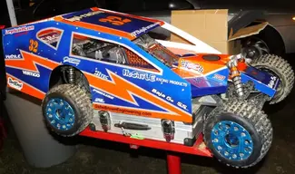

Hello if I may ask were did you get the body?Those are not rear tires on the front, just front knobbie tires.
I have ran my car with rear tires up front & like the handling that way.
You want to adjust for your steering, as the contact patch & turning geometry has now changed.
Depending on what your doing, sometimes it's nice to run different combos of front & rear tires.
This was made by a company called RCRC, which was the very first mfg. of these bodies for resale in the U.S..
It come clear, and the paint work I did myself.
I hear that RCRC has a new body he is working on, and a few are running out in the MD / DE East coast area.
