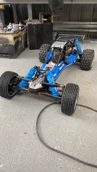

Hey there, hope you are all well.
I recently bought a used 5b SS - it needs a bit of attention and I want to do a few upgrades.
All the shocks seem to be leaking oil - what is the best solution for that? rebuild kit? replacements?
Rear lower arms and front upper arms are broken - should I replace with HPI items or are the alloy arms worth going for?
Hydraulic brakes - I'd like to upgrade the brakes to discs all round, or at minimum the fronts - what is the best kit to get please?
(any links for the above parts would be greatly appreciated - I'm based in the UK)
Thanks for any advice.

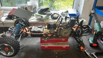

I don't recommend alloy lower wishbones if you're using the rig off road. They'll bend sooner or later and bind up.
Hydraulic front brakes are a decent idea.
Rear brakes I think very highly of this system:
TR 1 piece brake mount.
With a decent servo - like a Protek 170 TBL - the brakes are progressive and can be locked up on any surface! 😎
I quite like the precise adjustment option with alloy upper wishbones:
And I definitely prefer the centre steering push/pull mod:
Well worth the effort. Whatever servo you have will essentially have twice the mechanical advantage. 🤩
