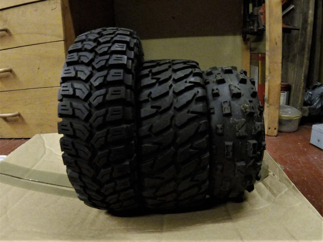

not sure how many people know the tires i'm gonna use, heres a pic though of the kraken maxxis trepadors i'm gonna be using,
trepador next to dragon hammer truck size tire and baja front,
