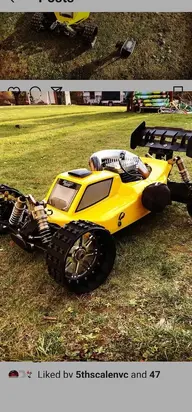

mounted up the shocks went one mounting location towards the inside on the front and went one down on the rear but moved the shock mounting location on the arms out towards the wheel.
Shock collar in the rear is set to 18mm down and 10mm in the front. This will almost certainly change when I get the rig back together and adjust ride height.

now I’m at the difficult part I’m dealing with an engine issue that was keeping the truck sidelined on race day. I’d hit full throttle and it would respond very delayed then when it did accelerate it would only hit about 50% rpms for a few seconds then randomly go to full Rpms. Then sometimes when I would hit the brake then let off the brake it would accelerate on its own. It would do this all very randomly and intermittently until it would shut off. I changed the spark plug on race day, then yesterday reset the coil gap and inspected inside the cylinder for scoring and tightened all screws yo make sure there was no air leaks. Just now when I went to go turn on the truck it was completely dead. I opened up the battery tray and wiggled some wires and power turned on🤔 again it would cut out randomly. I guess I need to take the electronics tray out again and do some more detective work. Hoping these two issues are related. If I’m still having engine issues after I fix the electronics then I will tear apart the carb and see if it needs a rebuild.🤷‍♂️
You named it Jim? 😂
Anyways, good luck, I would imagine the problem to be something electronic
I like them for their engineering too, but it's a way to overcomplicated design for me and my needs, but they are the best if you want a fully tuneable rig for racing.
i should get the Out Law instead of the W5 :ROFLMAO: since i love to rip the only thing i like to race is quarter mile street race for $$$ back when i was young:ROFLMAO:
Or buy @misterleon 's hybrid if he sells it and put your 71 in it if it will swap🤔
if he sell it i will buy it :love:

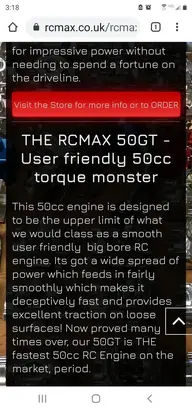

What are peoples opinion on optimum engine engine size for a W5, is 46 enough or would a 50gt be best all round.
if it is an ultimate then 65 supreme will be fine, 50 GT too much torque will end up like mine super 71
Speaking from a guy with absolutely no experience with big bores I say a 46🤣🤣
now you tell me :ROFLMAO: :ROFLMAO: :ROFLMAO:
