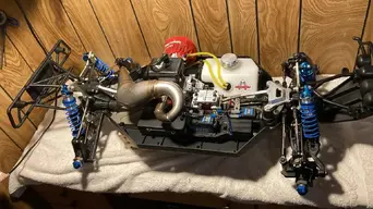

Boooba’s 30 degree north truck!!
She’s almost ready for her first fire!!

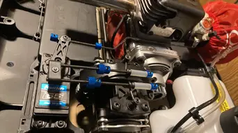

Can anyone tell me which fuel line goes where? Does the fuel line with the filter go on the bottom or the top of the carb?
The next thing I want to do is get the aluminum center diff housing and aluminum diff cups, upgrade as I break from there!!

That center diff tower will hold a big bore and unfortunately my knowledge has ended with giving you advise beyond a 34cc. The big bore guys will lead you to the right parts.
Hey I appreciate any help I can get!! I may not get a big bore just yet I do like this little engine i may just keep it in there for now.

Filter goes to the bottom of carb.
Stock Drive shafts are good. I ran my stock shafts with a 55 and haven’t broken one.

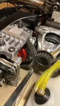

I just want to thank the ones who helped me figure out the motor mount issue!! The Cy fan cover did the trick!! I am so relieved now that I can roll this thing and it’s smooth!! Thanks again guys! To name a few,

don't know about yours but have a look at your rear center driveshaft, mine was slightly bent and i can see where ist been touching the fan cover a tiny bit. hasnt bothered me but thats only on a 29 with a 19t pinion.
I will definitely look at that
