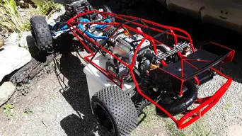

Yip had my fair share of runaways with my rovan 36cc Baja, not only damaging for the car and pride its flipping dangerous, running killerbee off 3rd channel now,,I had multiple runaways till I found the cause,soldering on original 6v battery not very good and under revs the vibration killed the power and bein on high rpms it was off,lucky I run my cars in secluded areas,,since have made me car almost bulletproof with 10mm front steering plate and bottom chassis so nothing bends no more..homemade cage
