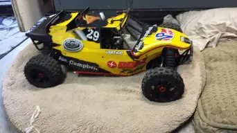

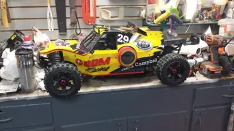

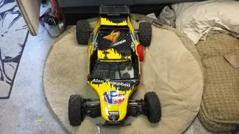

So far:
Have to figure out how to upload pics from my gallery
Zen 340 stroker with ESP full mod porting
Bartalone Pipe Unsilenced
TGN Redneck Air Filter
Outerwears all around (except shocks, my wife is making me some)
Turtle Racing Clutch Bell
Turtle Racing Motor Mount
Turtle Racing Clutch Housing
Losi Front / Rear / Bulkhead Chassis Brace
DGI Aluminum servo horns
Proline Blockades on Silverback 5imien w/ zero growth Hostile Foams
Proline Trenchers on stock rims and foams
Proline Bowties on 5B Split Six wheels
Vertigo Monster Locker Spool for center diff
Shock valve and rear spring upgrade
FLM dogbones / cups w/5mm pins at all four corners and drives
Custom wrap by Immersion DeSigns
DGI 23/58 pinion and spur combo
Grub screw shock mod with +20% springs (works fantastic, no more lawn darts)
Savox servos (235 and 236)
2S LiPo receiver pack
Some other things I can't remember.

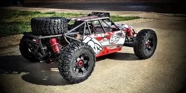

Finally figured out how to upload a pic...
So what your saying is the ideal total area for our pistons is a hole that's 8mm. . So 3.14 x 16 means about 50mm^2
Would be a total of 8mm in diameter per piston. So 4 x 2mm diameter or 6 x 1.3mm etc. As mentioned one guy is running 4 x 1.9mm diameter which to me is preferable over my setup of 2 X 3.5 ish.
I just measured the Losi shock rebuild kit pistons and there are 6 x 1.5 mm holes.
6 x 1.5mm totals 42.4 mm^2
4 x 1.9mm totals 45.3 mm^2
Correct. The factory installed pistons (not the new rebuild kit from DDM or Losi which are the 6 x 1.5mm) are 4 X ~2.8mm so the holes are too large and too much overall fluid bypass size for a silicon shock fluid and that is why a more viscous diff fluid is used that caused compacting / rebound issues. They are just too slow.
By reducing the overall bypass diameter and going to approx. 90wt. shock oil in the rears, 50-60 in the front and increasing the spring stiffness all around by +20% the shocks work much better.
The amount of nose-dive is decreased dramatically as well as the Dibby seems much more stable on the fast but not super smooth straights.
In any case it has seemed to work for my Dib and it is quick with the G340 and 23/58 gearing when running Baja 5b wheel / tire setup. I change back to stock pinion and spur (20/61) when running the larger Silverbacks w/ Blockade tires.
By no means is this a "perfect" shock setup but it does make a dramatic difference. I may yet go to the 5ive front shocks at all four corners to do a comparison vs. the modded stockers.

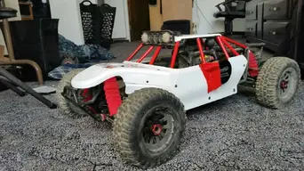

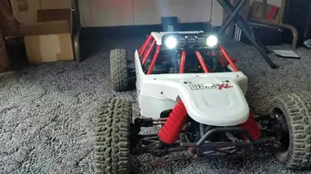

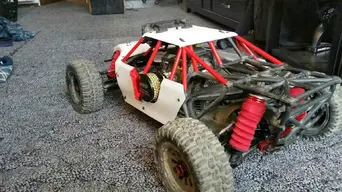

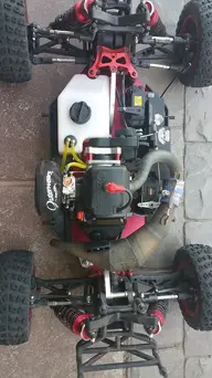

A work in progress. Waiting for my wrap to get back from the printer... Only frustration so far is not being able to fit the body panels on without cutting air filter location out, takes away from the scale look.
Will post more pics when I get my tires in and wrap done, running a bartolone racing ported g320 with a bartolone pipe, clutch carrier, chassis braces, team chase chassis, fit tank and mounts. Honestly it's a long list haha and still got some parts in the mail. I'm hoping that the fast eddie bearing kit will snug up the front hubs as they are a bit floopy.
And a short video, part throttle since there is very little traction with the stock tires and gears.
