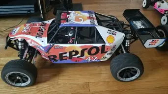

Took me about a year to get mine together.

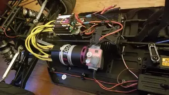

Right now, using two 6s max amps at 4500mah each , however i'm about to purchase two 7s max amps at 4000mah each. Max Amps seems to be the only company that I found that makes big batteries that fit the footprint of the stock DBXL-E battery trey.
Sounds awesome, are you stacking them because it looks like your esc is using 1 tray location, that's a sweet car btw!
yes stacking with,3m velcro on the batteries and long apex straps. decided to hold off on the 7s batteries, I spooled the center diff and I'm running 17/48 with 12s the car is uncontrollably Fast. I have to dial In the suspension before I think about adding more power.
I'm running 18/48 8s with a leopard 1050kv and mine car is also too fast to control, rate setting is at 75% now and is barely controllable, thinking 17 pinion.
