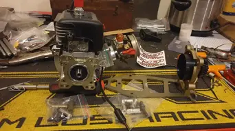

Had 2 hours after work today
Manged to get some stuff done
#1 fitted the hillantronics kill S
#2 changed the clone starter for a zen
#3 fitted an outerwears
#4 swapped the bell out
#5 dug out an 1107 walbro carb
a few things a checked like the headbolts , weren't at 7.9nm torque 🤦‍♂️ the screw in the front of the shroud was so short , only held in by 2 threads changed that. Re gapped the coil and the vstack was added👍🏻
Tomorrow ill fit the clutch and mount the motor 💪
