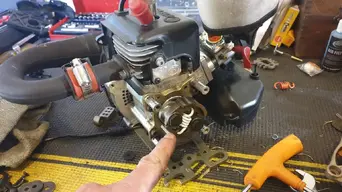

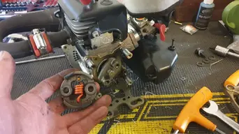

Yeah 9.5 is wheel spinning too muchYou went down to a 8k?
And the tires I bought are medium compound......its too hardI agree with Doug, I have 9k spring in the vekta and it's very hard to feather the throttle to get going. Pretty much spin all 4 till it starts moving, pretty much does the same thing if you let off while moving and get back on it. The stock tires do suck pretty bad though.

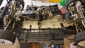

You can tune the shocks without replacing the oil. If you want heavier oil use a piston with less holes if you want thinner oil use a piston with more holes.So in order to get better performance out of the xr5 . I have lowered the ride height and doubled the preload on the springsill see if this helps with handling
@Team Ninja Pro suggested heavier shock oil
that will be the next step
Good plan bobYou can tune the shocks without replacing the oil. If you want heavier oil use a piston with less holes if you want thinner oil use a piston with more holes.
