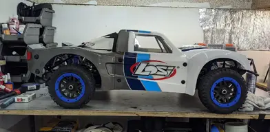

Man this thing is LOUD! I just love it. Here is very short video . Sorry no body on yet (shoe goo is drying).
Also, why is that when I turn my wheels left to right manually with the power switch off my lights turn on ??
Shoe goo is to make the body more durable. You apply fiberglass tape and apply the shoe goo on top.
Here is a video of it. The cars battery is completely disconnected. The green light on side flashing is my kill switch light.
Yeah please try it and see what happens.
Also, are these good temps? This is on factory settings. Really can't go full throttle because the car sounds like is too rich?
mine does it too ? ...i wouldn't recommend doing that to the servos tho...best way I can sum it up as is the servo motor is acting like an alternator and back feeding the reciever....not sure about Temps. I don't really check Temps just spark plug....when I put my pipe on i had to richen the low end a hair
