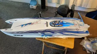

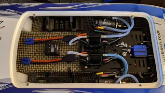

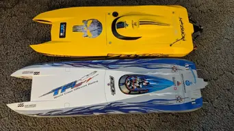

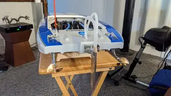

She's almost ready. Pulled the 2 piece flex shafts out and replaced them with 1 piece flexes. Installed Balanced and sharpened Dashboata Octura 442 props . Changed the Rudder out for a dual water pickup instead of the single pickup it came with. Pulled the ESC mounting plate out and ran all the wiring and some of the cooling lines under it. Also working on thumb screw setup to hold the lid in place instead of taping it down.Oh and I also cut off the yellow plug(not sure what they were ) and replaced them with EC5 plugs so that I can use any of my batteries from the Twin36 in it too.IMG_20200822_192721.jpgIMG_20200822_192446.jpgIMG_20200822_192511.jpgIMG_20200822_192539.jpg
