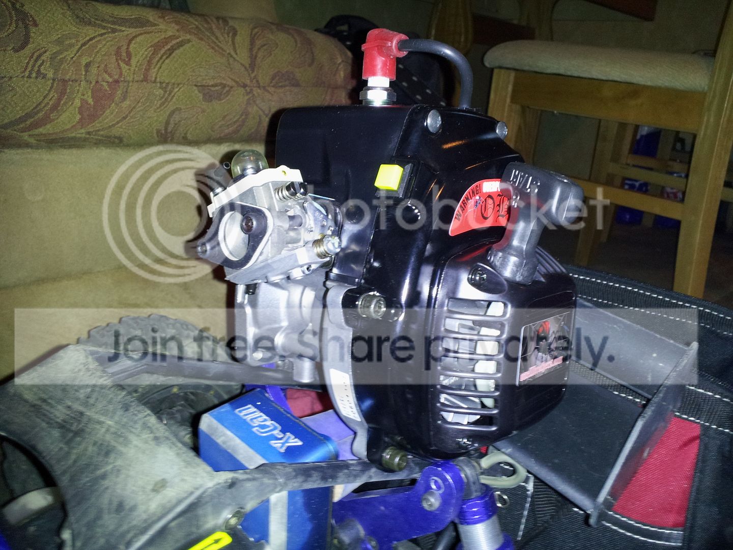

I put the GPS on the buggy today, and after getting it set up I ran a top speed of 30.4 MPH. I think that's pretty good for a stock HY rolling 5T Trenchers. And my home brew tuned exhaust. Could be better though, the engine kept cutting out as it hit peak RPM. Need to figure out what's happening, but I have a couple ideas. I have some driver POV GoPro video I'll put up later after it's downloaded and edited.

I checked the fuel cap vent, it's OK. Ordered a couple of clunk filters. When I set up the home brew exhaust this thing was crazy fast, and runs through a tank of gas much faster. Not long afterward this cutting out problem cropped up. I'm not running real lean and never have, between brown and tan colored spark plug, so it isn't that. Must of sucked all the crap out of the tank, though I'm careful to keep the dirt out while filling up, there is stuff in gas station tanks.

Replaced the clunk filter, it was plugged, put in the tank vent kit and cleaned out the top of the carb today. Letting the Loctite cure overnight, tomorrow I'll see what the top end is.
I think Team Chase had a filter for the vent at the back top of the carb, but I can't find it anywhere. I was surprised at the amount of gunk I found.

When I took the top off the carb and saw grains of sand on the diaphragm and all the passageways in the plastic plugged I remembered seeing the video about it on the Fast Eddy site.
