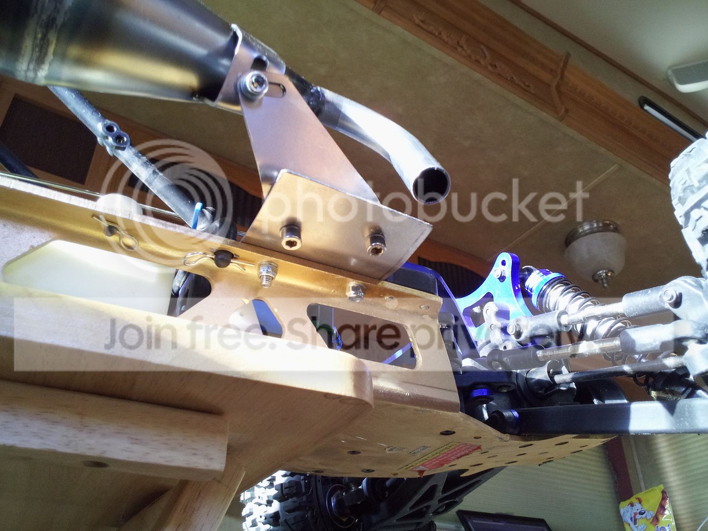

Verified with DDM I do have the "BIG BORE" pipe. Fits nicely on the Dune Runner, I need a 2.5"X2.25" plate to bolt to the chassis in front of the forward roll cage mount and put the front pipe mount on. The only place the pipe comes close to plastic is a small edge of the body. The plate will move the pipe outward a bit AND make it easier to undo the front mount when you wish to install or remove the body. Plus I removed the light buckets and got them out of the way.

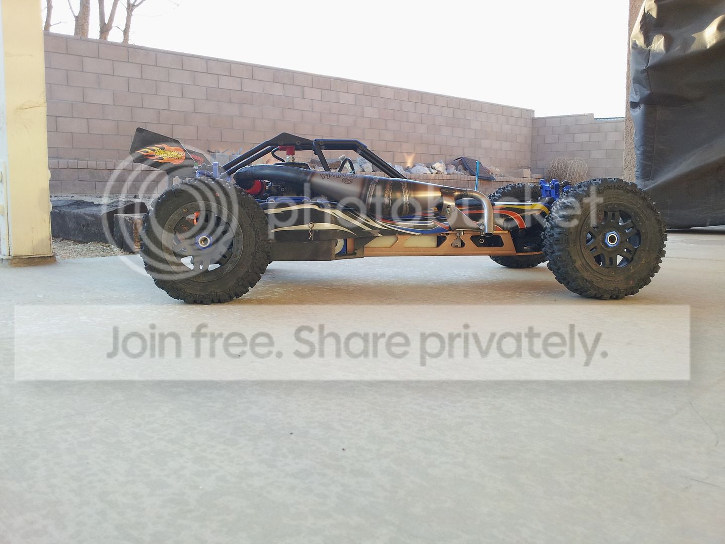

Finished the install of the VRC BIG BORE unsilenced side pipe. The buggy is now a "Full Function, No Frill's 4X4 Buggy".

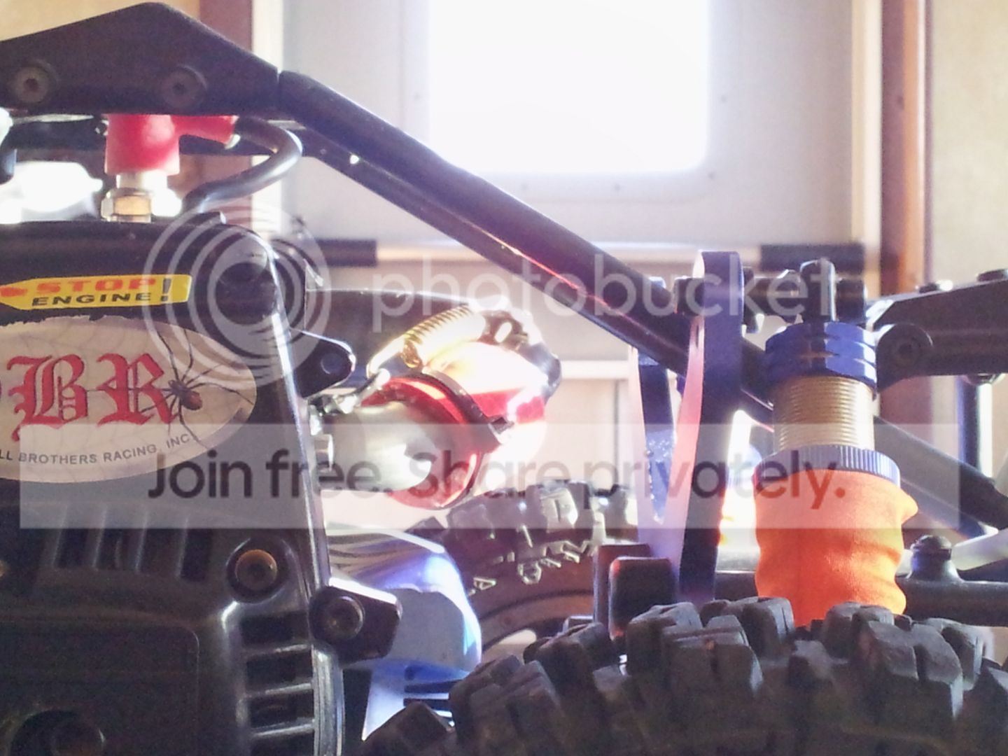

First, the front mount for the pipe:

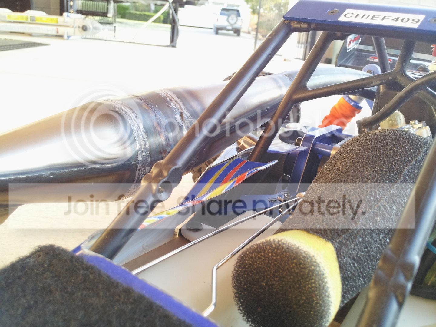

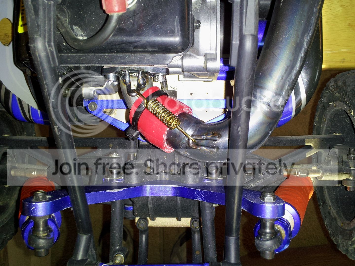

Body clearance:

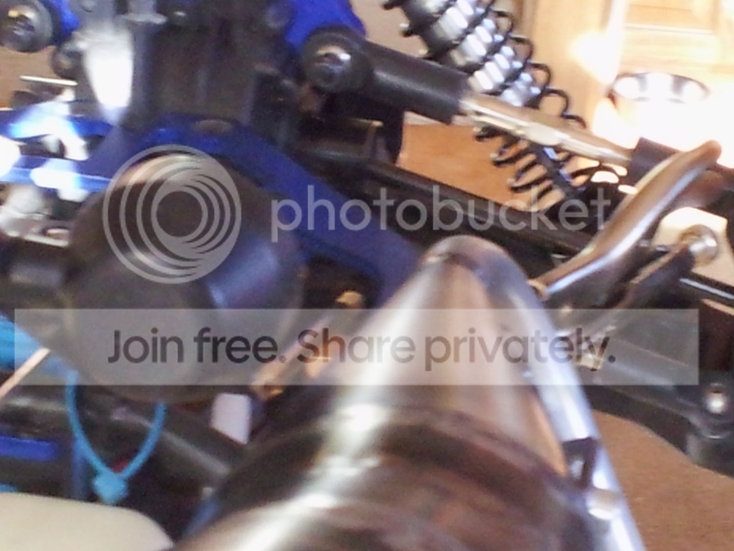

Front:

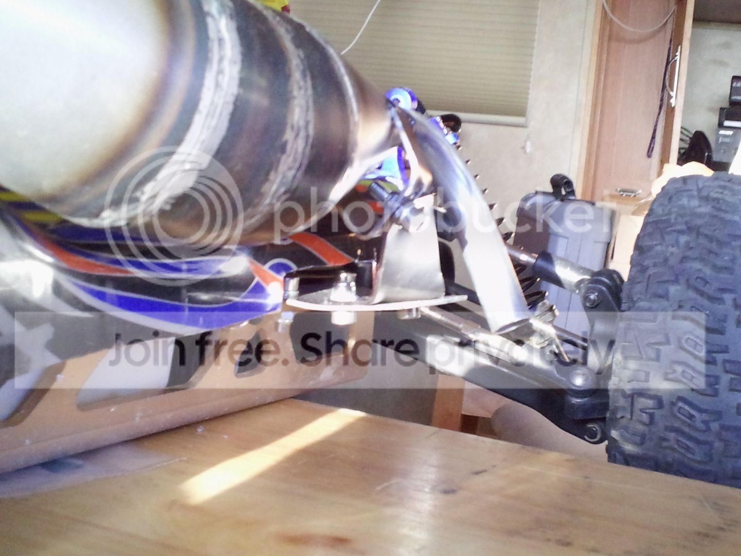

Continued,

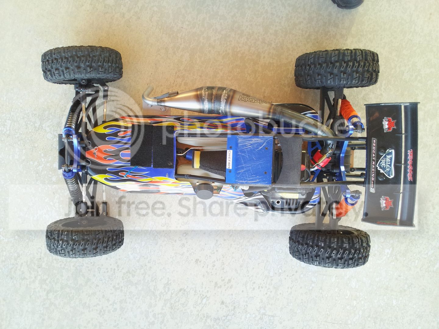

Couple more pictures.

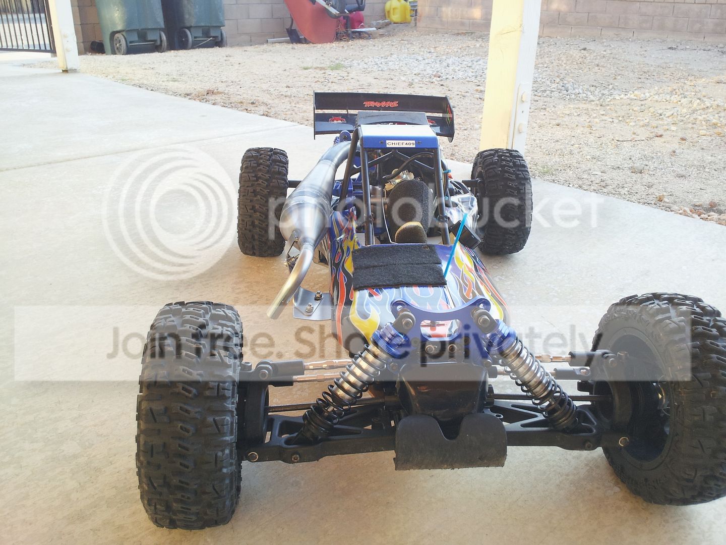

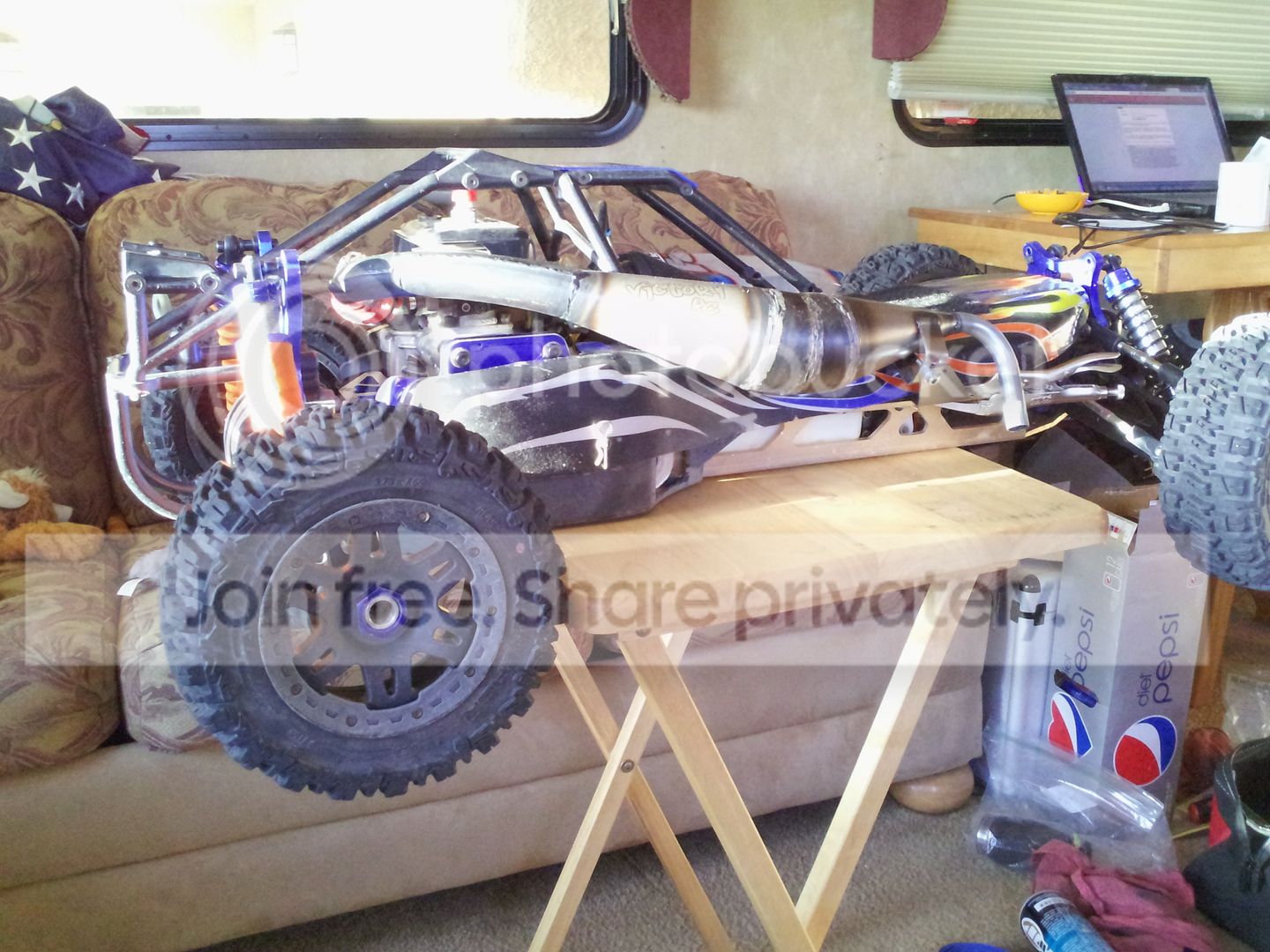

Side:
Top:
Since I got this from RC Pit Stop, I've been on here, looking, commenting and going for a Running 4X4 Buggy! Think I'm almost there, not quite, but closer! :)
