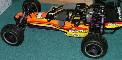

My Baja 5b has been pretty tough other than snapping the stock chassis at the front (pretty hard landing off a jump) That is what made me want to build a Vesla. I like having a solid one piece chassis from front to back.

I got my 5b ss in 2008! Only reason I went into the tranny is I didn't see an outdrive get loose till it was spinning the housing, ruining it. Put back a plastic housing and bought a bundle of bearings in bulk, been fine since.
I had trouble with steering arms, clutch bell holder, motor Support, all where plastic and I put those back integy orange. No problems for years after that. Had trouble with the rear dog bones falling out, then they came out with heavy duty and had bigger rear hubs with no toe shims. Also did the engine up with turtle base and ddm high rpm 29.5cc big bore. I had guys with 30.5's complaining I was lying that it was 29.5 ... cause they couldn't catch me.

Did you have the purple chassis baja the first batches of bajas? If you did those did have a lot of issues.
I can literally have a transmission out in under 15 minutes with a baja.
Yes. Purple chassis. That's what I've been saying this whole time lol. I had one from the first run of bajas.
First one in west Michigan in fact. 19-20 other guys followed suit after seeing mine. We raced them on my 1/5 scale track on the back of our property. They were constantly broken. So much so most sold them off like I did. I was bummed too because its still my favorite style of any rc.
