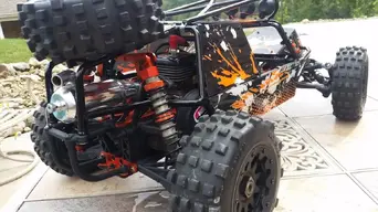

I agree, if your bashing go cheap! First flip or roll over its more than likely to get some damage. I'd stay away from the aluminum pipes, I didn't have my aluminum quiet pipe on for more than 15 minutes and had a tumble and it took some major damage. It's tucked up and under pretty well to. Glad I took this picture after I installed it.. At least I can remember what it used to look like.
