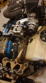

If I knew I had disassemble the center diff cup to change bearings I would have got a locker and been done.Now my cars in a 1000 pcs and I don't have diff oil.What's best center locker?
I'm sure glad we only did one car at a time.I can't remember where some of the screws go,especially after a night of sleep.

Don't put a locker it's puts a heavy load on your drive train
I would personally go with 1’mill maybe even 2’mill diff oil before I drop a diff locker ??‍♂️
BUT DDM has a couple lockers on their site, check em out ??
+1??
I want this to be the last time tearing center apart.So if I get the steel locker sm190 all I need?
there is no such thing as " last time " in 1/5 scale ????
That looks like a modified Rc diff mount ???
If so, changing the diff in the near future will be a breeze compared to now ??
and that will work but you need to make sure you have a matching vertigo spur gear
I believe this is whAt your after, someone pls correct me if I’m wrong ????
http://www.davesmotors.com/Team-Chase-Differential-Locker-for-the-Losi-5ive-T-2722.html
Yes it is,so you don't put the stock back on.
ok guess I will just get oil and wait....again..........glad Ihave 2 of these to run

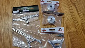

Hey the instructions are wrong,say custom bearing is marked with zip tie and has thinner inner race...I call bs,which is it.
Both kits were the same thick race bearing marked as custom bearing,
If I didin't have 2 kits I wouldn't have noticed
Any ideas?
Any ideas?
I honestly didnt even look at the race when building it. I just used the one with the zip tie where they said to use it??‍♂️
