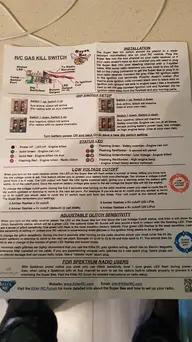

Hey all. Been a very long time since I've been into RC. I own a brand new 5ive. I've got many heat cycles through it. I bought the kill switch along with a Futaba 3PV TX. I cannot get the kill switch to engage when I shut off the transmitter. I have switch 3 to manually activate it. I'm at a total loss. There is not much info out there for this setup aside from 1 26 second video of someone who shows theirs working. Any and all help is greatly appreciated.
Are the dip switches on your superbee set right?
Top right diagram in the dip setup sounds like yours is set.

Thanks Seandonato73 I definitely learned some new stuff about the superbee. Glad that it is part of the programming. Are they pulling signal off the Throttle or steering to verify loss of signal?
Seandonato73
838
Likes
953
For that I don't know. I have mine plugged into channel 3. I assume it works off the lack of communication between the RX and TX because it's a telemetry RX. The TX signal loss was on the fact sheet on their sight. I just verified with my set up. Which is the same except for the RX is a R304SB. This is the video from the fact section on how to set up and how it works with a 3 channel radio.
