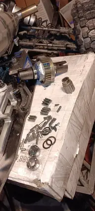

Can anyone tell me which layshaft I want to get for the big bore? I see Detroit has 3 different layshaft, I see one for the Baja and vesla, can anyone tell me if the Baja layshaft will work in the vesla ?
There should only be 2 options. Taylor Stock and blackbone for big bores. The shafts from vesla to Baja are different as well as gearing.

Thanks!! This is what I got so far. I know Im missing a few parts.
