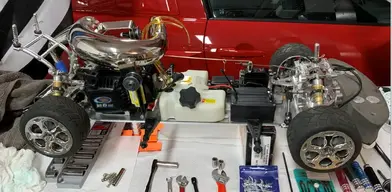

I got the front all cleaned up and the front brakes dialed in, they work awesome. Pic of rear and front end.
Here is a pic of the rear brake setup. it doesn't matter how much pressure I put on the lever, the rear wheels turn freely, so something is not right there.
With the front brakes working good, I'm not going delay getting this car running. That said, it would be nice to get the parts on order to fix the rear brakes, if I can figure out what to buy without tearing it apart.
