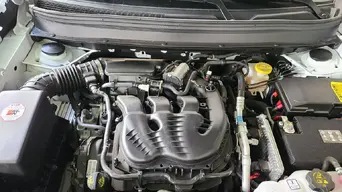

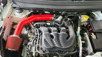

So I decided to get a Cold Air intake for her. Let her breath a little easier.
View attachment 75664View attachment 75665View attachment 75666
Coop that's not truly a "cold air intake" that's a "short ram" and not to be a peepee but those are notorious for wallet bait and zero hp gains, if anything you may have lost some hp and efficiency as short rams do little but just suck in hot air. I'm curious what's with the "K&N equiped" sticker on your oem airbox ? Do Jeeps come factory new with K&N filters ? I added a Injen CAI on my 2006 Civic Si and it was a ton of work (had to completely pull nose assembly off) had to trim the inner fender for clearence. Lastly on the Civic Si's you need to literally destroy the intake sound resonator box to remove it. When all was said and done Injen claimed a 10 hp gain and I didn't feel squat as far as any type of performance gain, but I do hear a lot more air turbulance noise when mashing WOT . The good is I also didnt loose any fuel milage efficiency.

What ever. https://www.rpm-motorsports.com/store/p310/2014-jeep-cherokee-intake-cold-air-intake.html . You can argue with RPM Motorsports. :ROFLMAO: :ROFLMAO: :ROFLMAO: I have a K&N flat filter in the stock air box . That's why the sticker is on it.
Think about it for a minuet coop. You went from a sealed airbox that got fresh air from the fender or front clip, to a filter open filter sitting next to a hot engine. Looks cool yes. Functionality ah not so much. Same thing happens with the idiots that run open filters on top of carbs. They suck all the hot air in from the engine instead of cooler fresh air from elsewhere.
