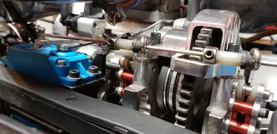

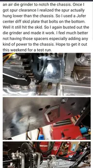

It wasn't pretty busting out a grinder on a work of art chassis. But for me to not use the spacers under the center diff and center shaft bearing carrier it was worth it. I did grind a slot for the stock spur and used a skid plate to cover it. The brake arm issue. You must have too thick of ahim on the top plate. I was able to make two shims for up top and still fit the brake arms yet allow spur clearance. 20190808_225149.jpg
