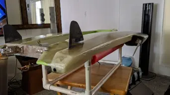

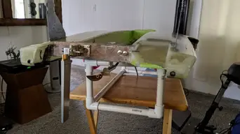

So update time . In one of the pics above I mounted the rudder on the Right side of the transom . Did a lot of reading and decided it was better to mount it on the left. So off it came and then I had to do some fiberglassing to fill the holes that I had drilled in the transom. So today I re-mounted the rudder and mounted the strut and water inlets . Last week I mounted the turn fin. on the right sponson. Actually making some progress . Although its time to slow up a bit. I need to put together all the wings and then mount them before I can mount the engine and drill and cut the hole for the stuffing tube and drive shaft. I have to figure out where the center of gravity is in the boat with everything in place and use the batteries to balance it. IMG_20200517_145622.jpg IMG_20200517_145641.jpg

So update time . In one of the pics above I mounted the rudder on the Right side of the transom . Did a lot of reading and decided it was better to mount it on the left. So off it came and then I had to do some fiberglassing to fill the holes that I had drilled in the transom. So today I re-mounted the rudder and mounted the strut and water inlets . Last week I mounted the turn fin. on the right sponson. Actually making some progress . Although its time to slow up a bit. I need to put together all the wings and then mount them before I can mount the engine and drill and cut the hole for the stuffing tube and drive shaft. I have to figure out where the center of gravity is in the boat with everything in place and use the batteries to balance it. View attachment 58860 View attachment 58861
Now thats a project. Looking good Coop👍🏽

You gonna play with the battery placement before making them permanent? Idk how it goes in scale, but we ran most the weight in the back of race boats.
Yup I'll be playing a round a bit figuring out the center of gavity front to back. The CG as I understand from reading should be about 1.5 to 2 inches behind the turn fin attached to the right sponson.
