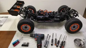

So I've got my new Fox today ;-)
The first thing I did, was to take off my Receiver, cables extenders, sensors and engine fans from the old Losi DBXL-E V1.
On Friday I'm going to take all of my RC cars ESC's connector from EC5 to XT90 - after that, I'll install my mod's into the new Losi DBXL-E V2.

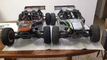

Did any of you have the chance to check the compatibility of DDM Jofer-RC Skid Plate for DBXL-E (db195BK) for the V2?
If not, I'll check it before the weekend - as I'll sell my old V1 RC (with these skid plates installed) on Saturday...
nice man, those fox shocks look pretty cool .... I suggest you start your own thread for your build so we can keep track of it ??

I've just taken my old dual fans (same item as I've written about previously) from my V1 DBXL-e - will install it on the new one :)
