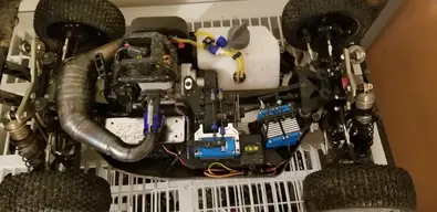

I got 2 845's for steering and an 840 for throttle/brake on the 5ive B.
I did not install any spacers on the 5ive B. There is still space under the throttle servo. Also I think if i put spacers on the throttle servo it would sit too high for the servo brace to work right....i could be wrong.... I might try a spacer just to see.20180822_212557.jpg
The only mod I did with the servos is I had to cut away part of the 840 servo case in order to get the RC Rock Armour servo brace to fit on the throttle servo.
Im pretty sure that battery has the same dimensions as the stock 5ive T battery(kind of what Killer RC made it for) and it will fit in the 5ive b...I'll take some picks of the stock 5ive t battery when i get home.
