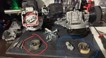

I could be completely in left field on this but I thought I read somewhere you have to use this CY clutch plate on 5ive-T to prevent the shoes from binding or something?
I’m putting my G320 in my 30DNT and I have to swap out the bell housing from the engine that came with it. The engine on the left (red) is the Z the one on the right (blue) is the engine that came with the truck. I was going to keep the z hardware the way it was. Not sure if I should use the CY plate instead? 🤷🏻‍♂️ thoughts? IMG_3026.jpeg
Before you take apart the zenoah see if the engine lines up with the holes on the chassis. Just thread a few bolts into the clutch bell housing so you can see if it lines up, if it does then your v2 is copied from the 2.0. If not then yea it's still a v1 and you'll need to use the pullstart cover as well
I couldn't fit it in there without the housing with the cut out because the brake was hitting. I've got everything almost ready to get swapped over anyways so ill try tonight and see before I put clutch in.

@GazooRC the g320 engine uses its own clutch housing, the bolt spacing is larger and the hole in center is also larger. If it's cut out for the brakes then it's copying the 2.0 layout.
Now you tell me lol I don’t know why I didn’t think of that before I started. Oh well I’m on hold until this plate comes in. Hopefully I have it before the weekend.
