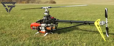

Just wanted to share an update. My friend and I are now making our own Gasser conversion kits (G-Thangs) for existing models. My TRM 310 is absolutely killer with the Quickdraw pipe. I have around 1.5 gallons on the the QD pipe and 5 total gallons on the 310 with 990 carb. I am upping my octane from 93 to 100 next as I am getting some detonation/hesitancy still at full pitch under hard load. I am running the engine now at 16,500rpm. I am going to try modding the 1107 carb after Christmas to try and get just a little more response out of it. In the video link below we were running around 15,500rpm on the engine. It is much much more powerful now with the tuning changes. Hope everyone had a great Thanksgiving and has a good Christmas/new years.
