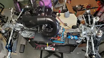

I'm collecting parts to start my 5ive-B build. Is the throttle/brake servo brace needed? Parts explosion drawing appears to have the brace built into the radio tray.

I say get the brace. It stops the radio tray from dancing around when you hit the brakes.
Silenced VRC is a nice pipe and you will be satisfied. I got it just in case I go racing with my 5ive and a silenced pipe is necessary. I prefer my Olimat for straight performance.
Losi brakes are great in stock form so if you are having issues, it's your setup.

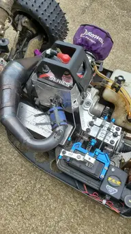

Regarding the brace, which one to get. The 5ive-T 2.0 brace may work, LOS251075, plastic and hopefully will not deform the stock diff uprights. I'm basing this only on looking at pictures on horizon. I've also seen TLR356003, carbon fiber. And RC Rock Armor.
Any input on which brace is best?

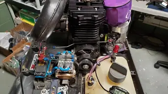

Is the heat shield keeping heat from the pipe off the engine? Along with the holes in the plasic side guard letting heat from the pipe out?

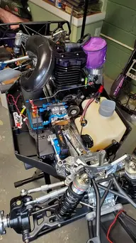

Hey they have the booted brake disk set on sale on Detroit if you are still looking for a brake upgrade.I just thought I would toss that out there.
Thanks. Looks like the pics above show the 5b brake pads with booted brakes and modified rc towers.
