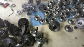

^^2-speed locking adjustable differential THE CRAFTSMANSHIP IS ONE OF A KIND so far from what I can see!
This thing looks and feels damnnnn near bullet proof. I say near because as most know, that's a one of a kind sales pitch in efforts to being "bulletproof"
Here you all Can see the comparison between the bell housings thickness and the Vertigo's vented clutch bell.....
^Vertigo=Black.........KillerRC=Bare
I decided on 17 tooth first gear and 21 tooth second gear to give me the best of both worlds
Here's the weight difference between the vertigo bell with vertigo 19 tooth/ DemonRC -speed with BOTH gears (17/21) installed

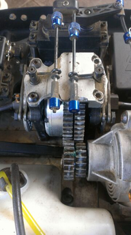

The only problem I had with the modified/2-speed were the single brake screws setup. They protruded through the bracing and bc of the DRC 2-speed adjustable lockers IS SO HUGE, I had to dremel the smallest screws offered in the kit and use loctite to secure the brake pad bolts. The bottom brake HOLDER didn't need any modifying. I'm sure when I go dual fronts, I wont have that issue. Thought I would throw this out there. Other than that, great kits between the two combined! Nada issue with a little dremel/screw cut

1st gear is 17T and 2nd gear ratio is 21T. I used the stock 19T on the rear engine casing side and button head screws on my front (2) motor mounts. If I had some random size T spacers then I'm sure the front could be matched up with spacers like the rear. That's my ONLY suggestion to DemonRC on the front mounts. It seems DemonRc in the future might be able to offer a more stock ish solution with spacer per customers specs. I'm confident with the button heads though. NADA one complaint. Waiting to get this Go pro mounted up and recording for you's. Anyone know how to work this GoPro hero3 BY ANY CHANCE?? The goofy thing didnt come with Destructions! Lol

Could you post a picture of the UNDERSIDE of the chassis, to see how the engine is attached?
How does the 1st and 2nd gears mesh?

I used button heads on the clutch side motor mounts and used the stock 19 tooth spacers on the back 2 motor mounts for now until Demon can get me the correct spacers for the front.
