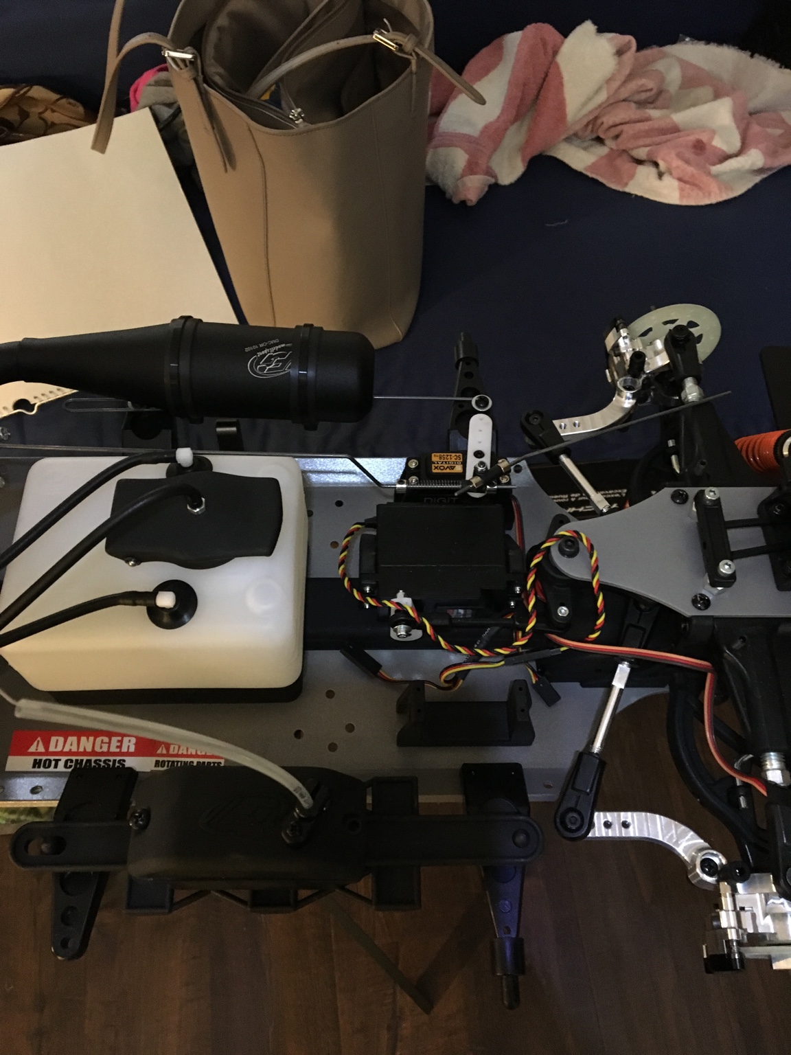

My plan for the radio relocation for third servo
well done looks good and much better with alloy hubs will be a very nice brake setup once complete and probably the first 4wd running them brakes/hubs
I could use some help from anyone, I need ideas for mounting the master cylinders.
