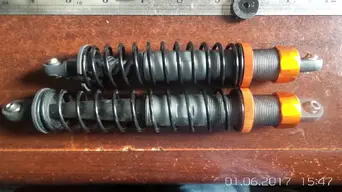

Decided today to work on lowering the baja by using fuel line on the shock shaft. The top one is the modified shock. The bottom one is the shock in stock configuration.
You can adjust the the rods on the upper arms by making them shorter or longer, there are also spacers in the front upper arms you can change out..You will see the angles of the tires lean in or out depending how you adjust them, so your tires wear evenly.

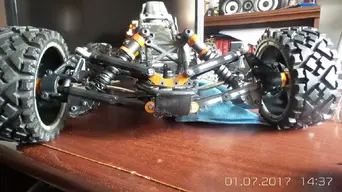

This is with the front shocks rebuilt and reinstalled. Clearance is about 1 inch from desktop to bottom. I really like the look. Now to do the back ones. I'll order a camber gauge later but won't worry about adjusting camber until all suspension work is done.

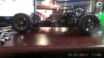

Completely lowered, front and rear. It's a very cold day here today so I decided to get at last the lowering done. It is really in the weeds now and has little bounce on the suspension. I used 40w oil in front and rear shocks.
man that came out nice and level, what kind of body are you thinking about using? Do you have sway bars on ? Nice work Preach.
I am pleased with it. The front sway bar is broken, but the rear one is intact. Right now it is pretty stiff with very little suspension travel at all. I think that is a good thing. I'm going to order new sway bar links and I'm thinking 10k clutch springs. I had not ever considered what body to use. I think I'm too far from that right now :) I also need to so some studying on the gear ratio.
