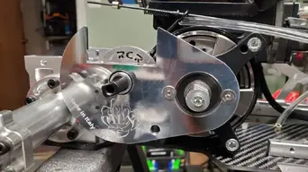

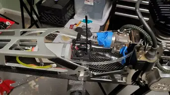

Little update. Had to modify and make some engine braces. Spaced the front pullstart side out about 10mm and drilled and tapped the coil mount. 20210216_175648.webp

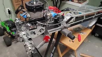

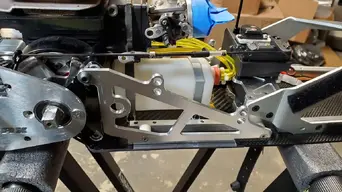

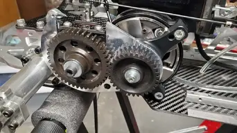

Had to cut the front clutch side lower mount hole off and use 10mm spacers also. Top bolt mounted perfectly to the 80mm bell carrier.

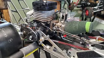

Fabricated the rear pullstart side brace out of aluminum. Used existing holes in the axle upright mounts.

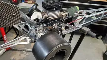

This is the rear clutch side brace from alx I'll use.

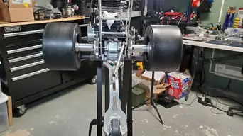

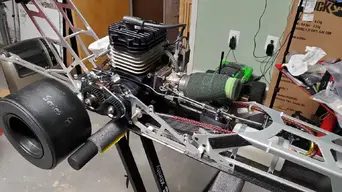

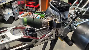

Old gas tank location was getting trained by the big block and electronics box?

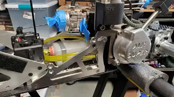

New location. Mounted. Just need to run the lines.
