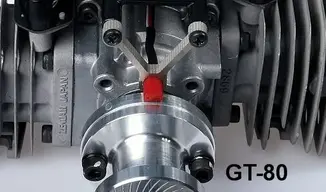

Something like thisNah I was asking how it picks up. Lol. What is your engine supposed to look like when finished? Actually just want to know what the flywheel and pickup area is supposed to look like when finished. The stock setup.
Yep. I'll let to find a smaller diameter flywheel but I don't really think that's Gunna work outGotcha. Yeah that may be a problem. If it was like one of the 2 pics you sent 1st then I could see how to do it but your setup is quite different.
