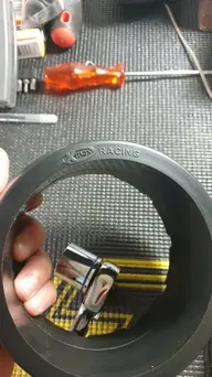

Got a set of foams in today?? the previous ones where madmax and pretty soft? thses new ones are "xmax racing?" Never heard of them?‍♂️ quite firm?? id even say twice as firm as the last ones20201223_173001.jpg
They may last a bit longer ? well I'm hoping so??
