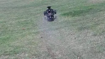

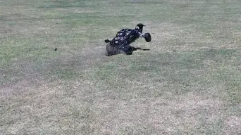

So took her out for a spin and I blew a foam in like 2 mins?‍♂️?
Still plenty pep??
