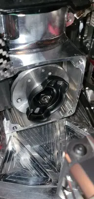

Someone didn't tie the knot too good and never hit it with a lighter. Or did the pawls grab the recoil and snag the reel? You will see more unfortunately when you open that recoil up, I'm feeling your pain!...just went through this 2 vids ago.
The delrin pawls may need 1mm machined off if your pullstart reel looks like this.

Everything looked good inside on mine nothing broken. But I guess someone put a extra nut in mine. Didn't see a place to install it so I didn't . Works good now.
