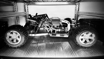

Project Update. Decided to Handcraft on a Carbon Fibre 80063-3 ESC Mount
Wanted to but had to settle for the 40063. The huge and awesome '800' could never fit my platform (FG F1 Competition). No headroom, everything must be on the pan - one level). As it is, I had to extensively modify the chassis. I won't get that full 50+hp, but the motor should run cool :)

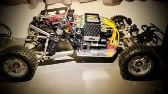

Working on a Carbon Fibre MGM 80063-3 for the KV5TT, need to do a mock-up to make sure that ESC is secure, and Batteries and Capacitor Fits, and no bind to the cage when the Body is Installed. Yes the MGM800 is HUGE and absolutely necessary to use all horses of the NEW LMT30100. Yes it barely can fit into a Kraken. Someone attempts FIRST into a Kraken Vekta.5, He installed its on the Side. Anyways, this is the first attempt into a KV5TT, according to MGM. No way in a Five-T or Five-B if that's what your thinking.
Based on this mock-up, looks like it's going to mount Secure and Safe. I genuinely Exhilarated & Elated, as well.
