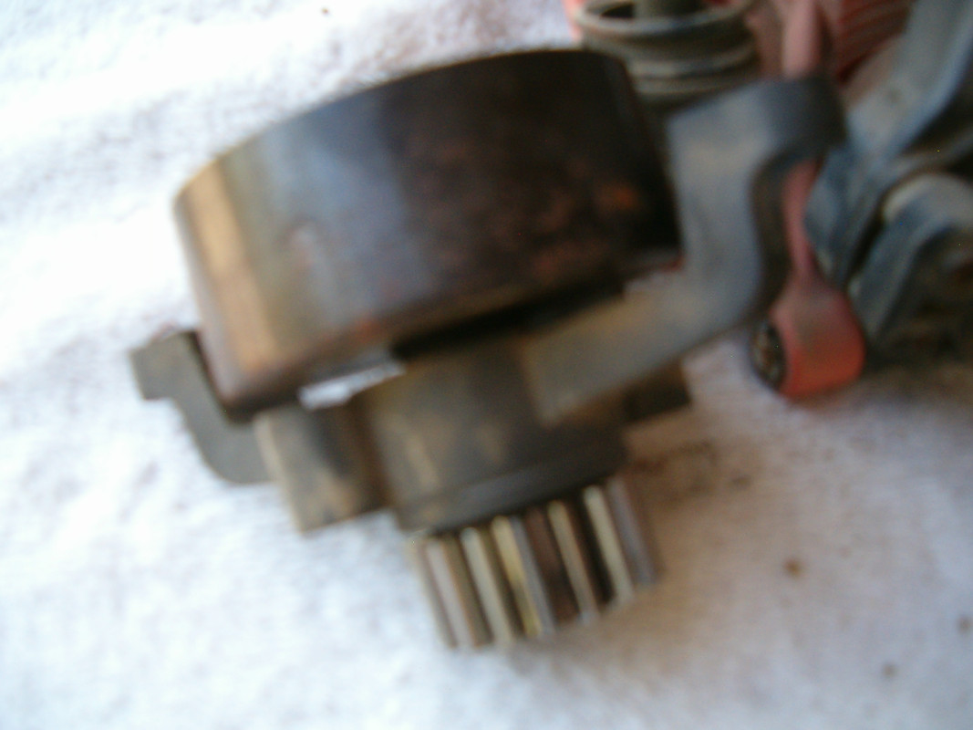

Here is what the shoes look like!

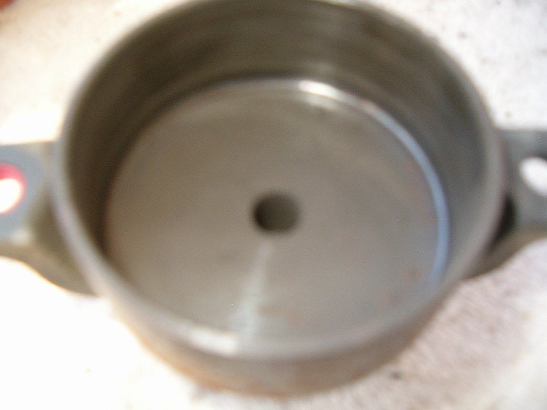

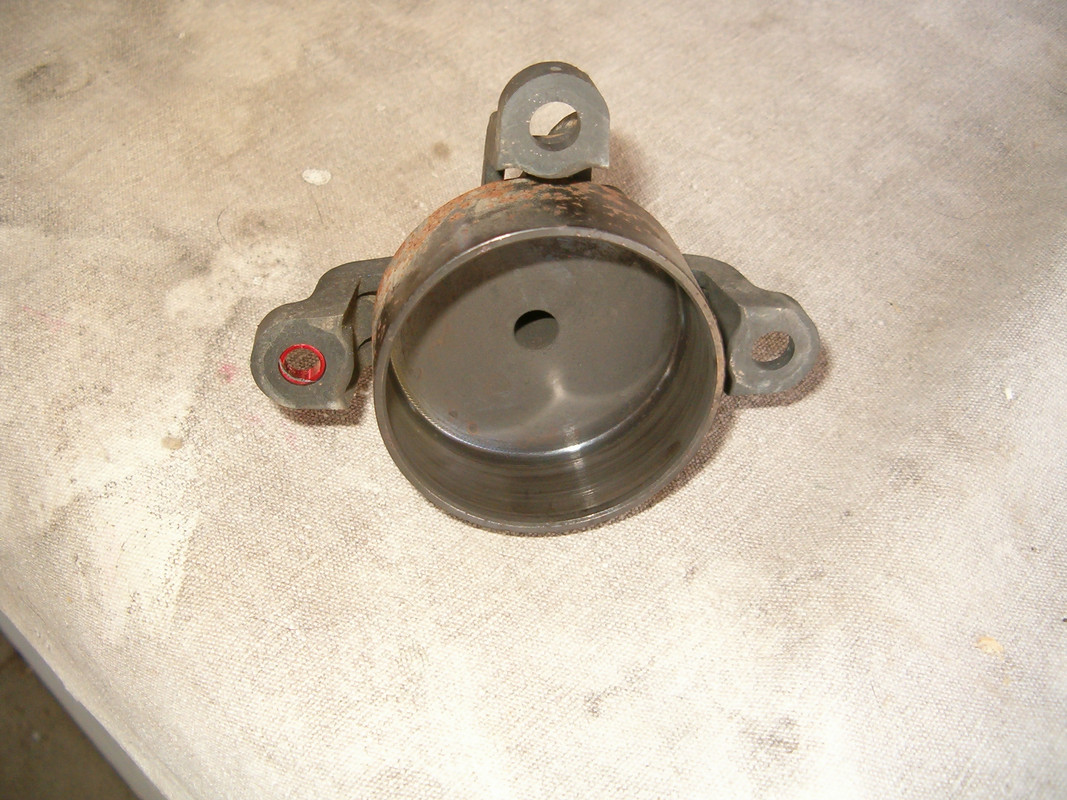

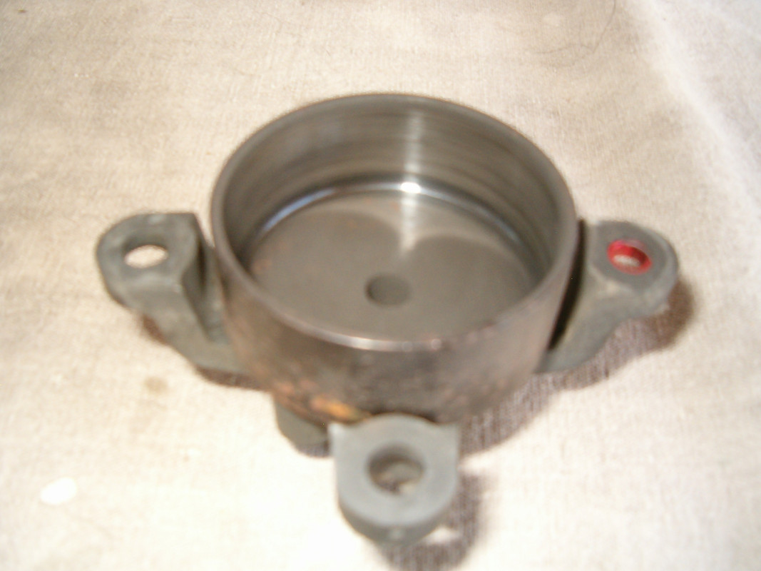

The bell ,as you can see ,never got too hot ,if it did ,you will see bluing ,it is not there ,the carbon bearing carrier is
not distorted in any way ,an the bearing is still smooth an no slop!
The inside of the bell is in great shape & is still meaty with out any deep grooving ,or ridge at
the outer section ,it still looks new!

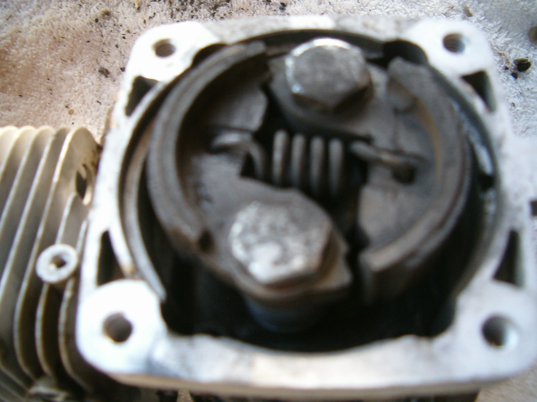

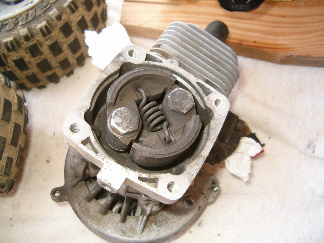

There we go, now were not squinting lol. Yeah them clutch shoes look pretty far gone
I could tell the difference in the launch ,an also full wot from the last 2 runs that I did with it ,frm
a few years back from those runs ,but that last few years ,the buggy was ran in the street ,so
street running may have worn them out faster ,just because the buggy looks dirty & nasty ,also
old ,It really hasn't had a whole lot of run time on it!
I had also seen worse ,I seen clutch shoes completely gone ,metal to metal ,an the bell completely
severed into two pieces!....LOL

Yeah they aren't horrible but they aren't good. I'd definitely replace em while yet in der.
I have shoes in my stash ,I will check an see if they fit ,some are at least a 1/4 '' thick of meat on them!
It looks pretty grubby in there, would be a good idea to check your crank seals whilst your at it.

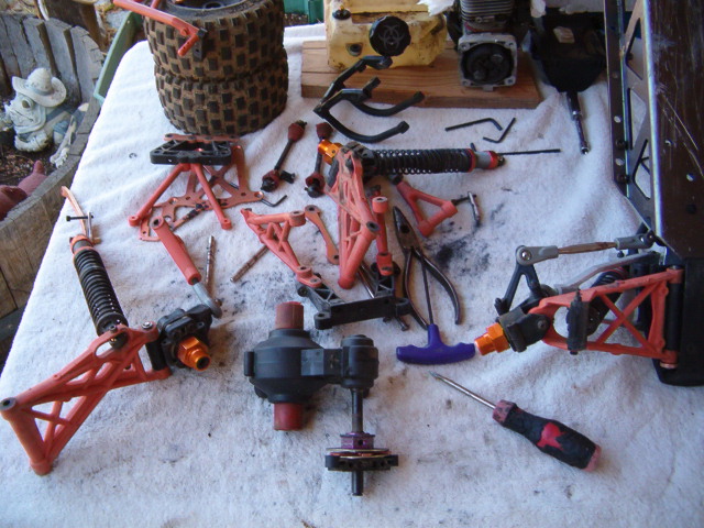

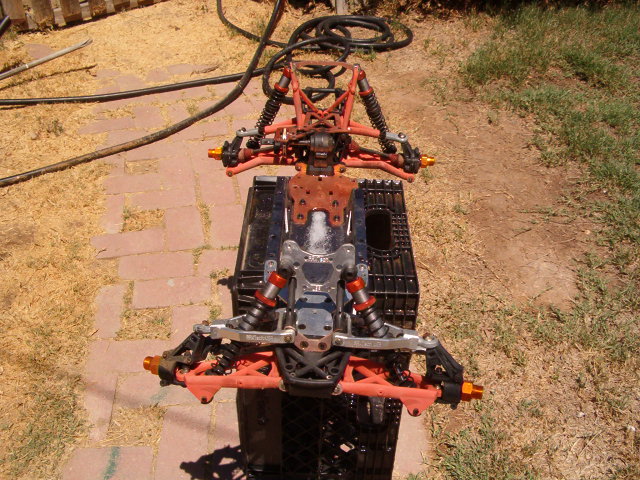

I power washed it ,tired of getting my hands greasy ,I am fixing to take the rear end apart!
The one pic is a towel ,that isn't grease ,it is actually clutch dust ,it was a lot!....the shoe pads are as thin as a
soda carton in the middle of the pad!

I haven't pulled the diff apart ,I don't think that the idler bearing are gone ,but you can see that the outdrive bearings
are gone.
