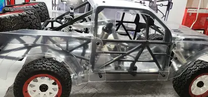

Me too brother! I have a little time to think about what I want. Its gotta be special this is my first build, After the holiday will be the engine and paint or may even go Pitdawg hydrographic wrap. Engine is already on order. And thanks guys for all the ?!Can't wait for the paint job????
Went with the rc max 65. I was hoping to see Harics results because its never too late to go bigger.? But I chose the 65 over the 71 and 80 kits because I'm very hesitant on cutting my brand new body and cage up. Also I ordered the vertigo trans kit and upgraded clutch with it as a package. Harics right even the vekta buggy panels are very RARE at this point. Much easier of a mod though on the buggy with Harics custom aftermarket carbon fiber panels. I need someone to carbon fiber form me some of these TT bodies.What motor?

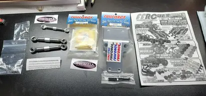

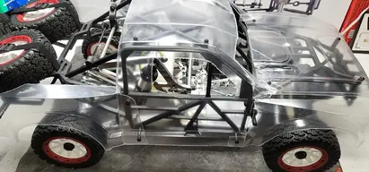

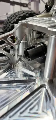

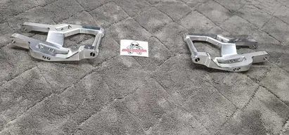

Alright picked up a Life battery for the new futaba 7PX, RCMAX diff cover from Detroit Performance, sway bar links from IRP, Vertigo billet trailing arm mounts, wheelman designz heim joints(x2-? and a trailing arm..last one available?..first mishap,talk about that later!) A fellow LSF member came at me with another lexan body set and livery so I got 2 to experiment with mad props to Braap2smoke, thank you buddy! And order is changed and just in time,my engine was being built, Thanks Mike and John for the change order! I'm going big or going home with the 80???

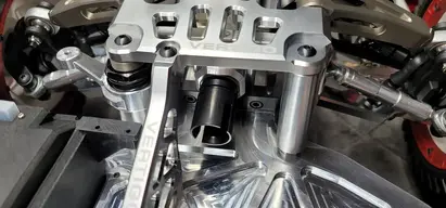

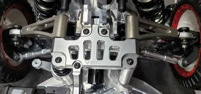

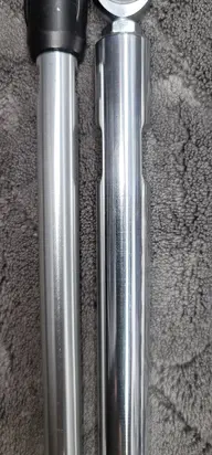

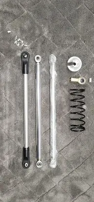

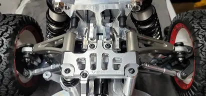

Update: IRP steering links are the ticket! Waaay! more articulation. Only thing I dislike is they could be a tad shorter so I can toe them out a bit if I want, I'm sure I will be making adjustments in the future. I'll log my specs so if anyone else buys the TT and the add ons, so it will make smoother sailing.A few more goods showed up today, close to being done with upgrades and chassis hopups, switching from JS Performance steering links to IRP, I believe the heims in the IRPs have more articulation. I noticed my front suspension should droop a bit more and when I extend my upper arms to adjust the camber and match the stock length the steering links do bind a little bit, I did not notice this till I was playing with the front suspension adjustments. I do have all billet upgrades except for the carrier and spindle set and maybe this is to blame. Ddm said they will be in stock soon with all our Vekta billet upgrades can't wait.
