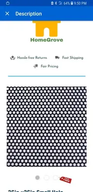

What you guys think about fabricating this aluminum into window neting on windows and a couple other open areas on the cage to offset the beadlocks and but painted red to match? Just a theory....
