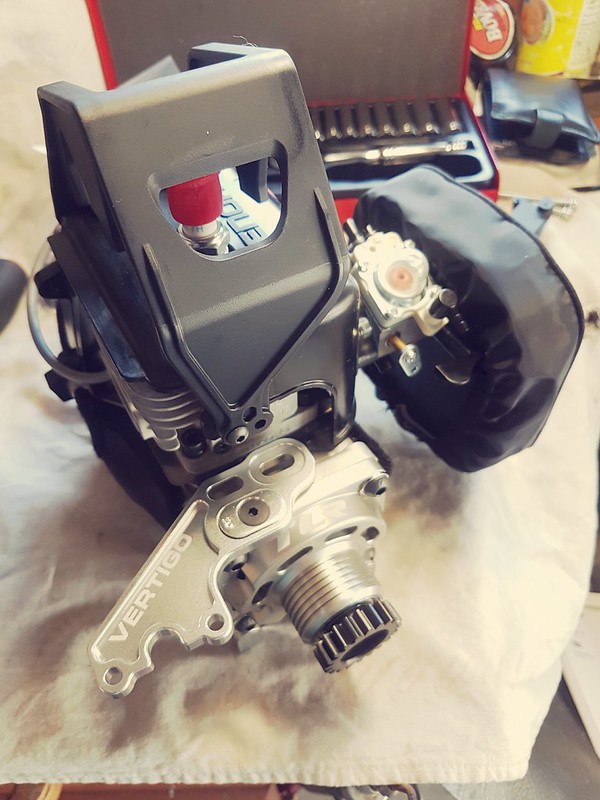

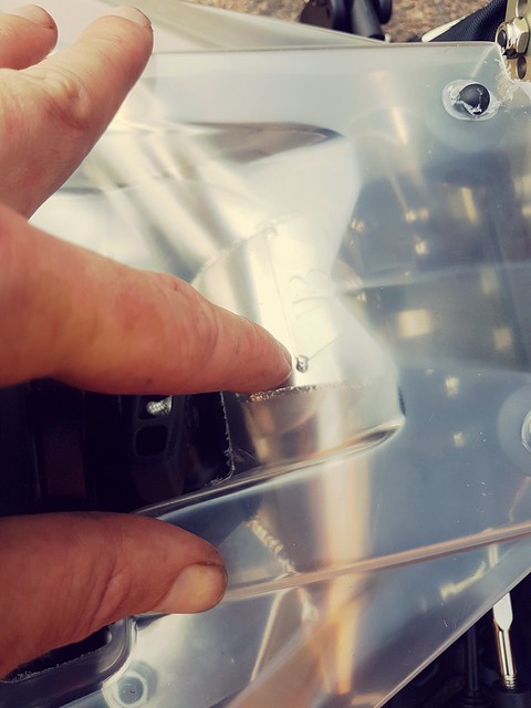

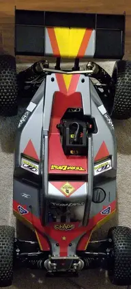

The body is pretty low but it does make getting to the pull start a pain on my build. You can see where the pull start is just bareley not reachable when the body is on.
Zoomed in picture of the issue.
On the body that ships with the kit the cut out for the section where the pullstart is is angled. The stock Losi picture shows the cut out is more square.

Solutions::unsure:
Cut the body so that you have easy access to the pullstart.
Or
Use 1 to 2 inches of muffler tubing to extend the pull start (y). Anything more than that and the pull start will be sticking up past the top of the spark plug protecto but I don't have any pictures of it. The pullstart I had on that motor finally died and I'm going to end up cutting the body anyway. Booster pipe from Detroit Performance makes contact with the body in a few places and it melted.

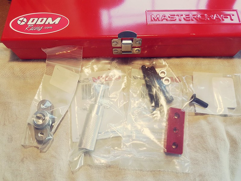

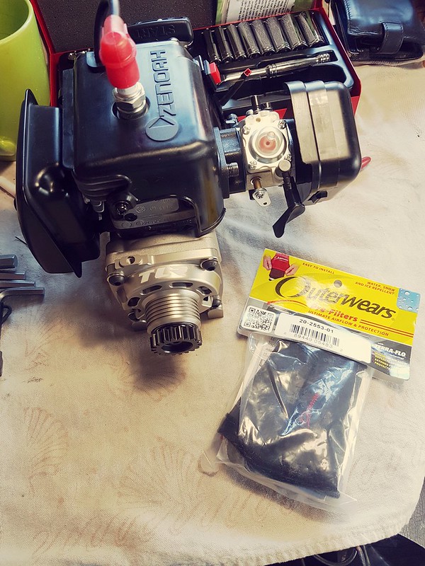

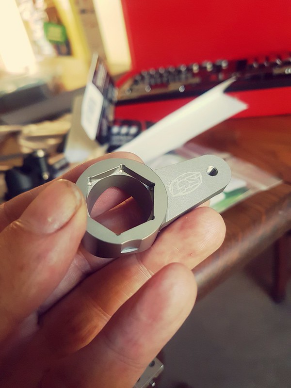

YAY! I got mail today
piston stopper flywheel puller and a cy clutch plate. i changed the clutch plate now im ready to install the G320

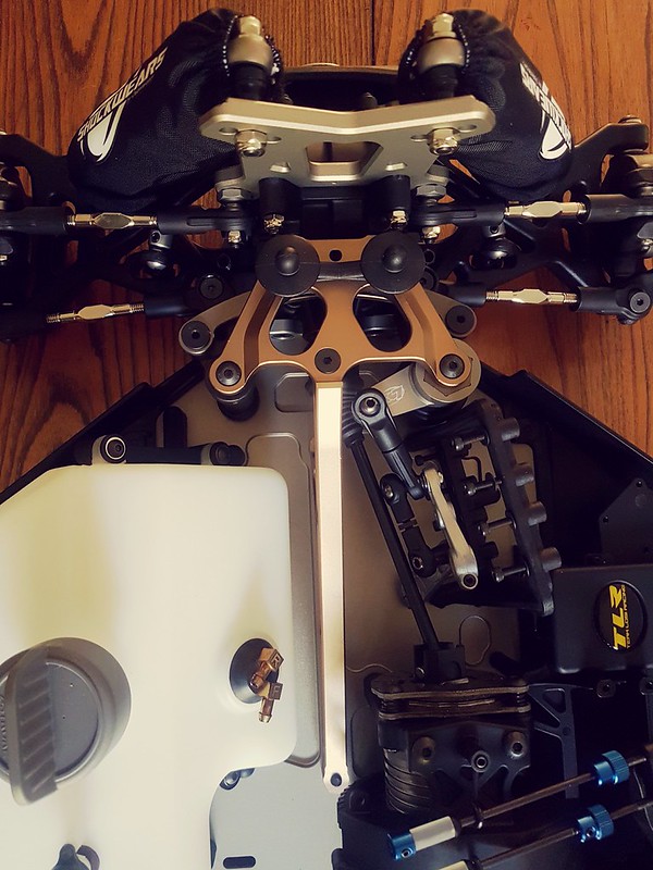

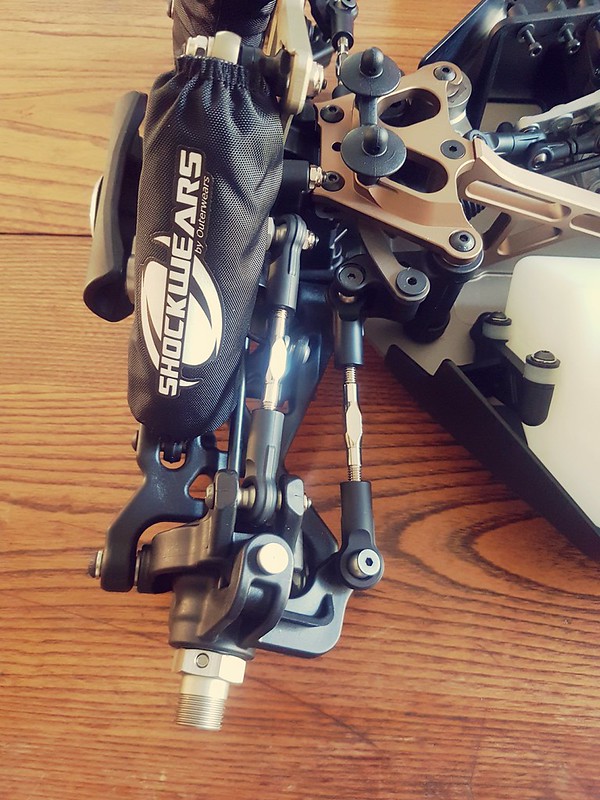

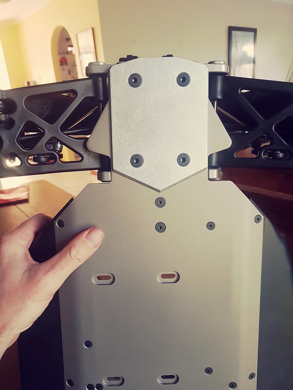

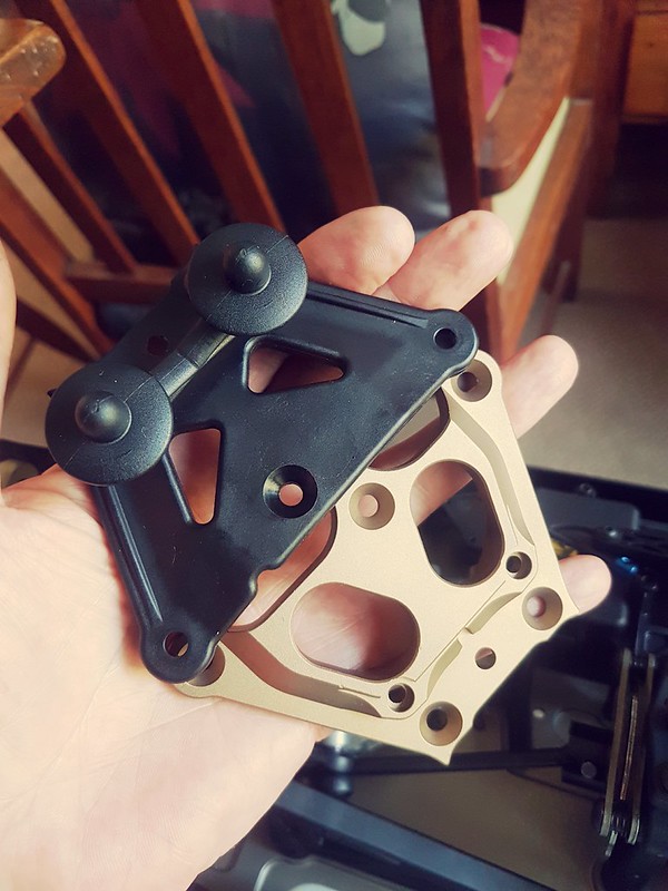

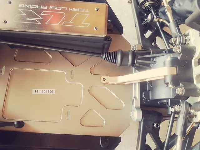

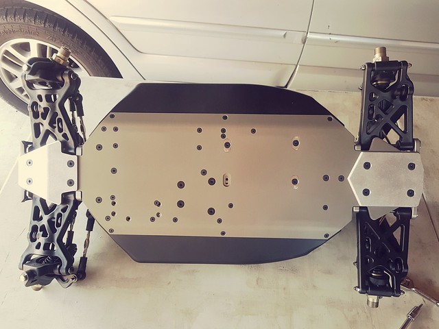

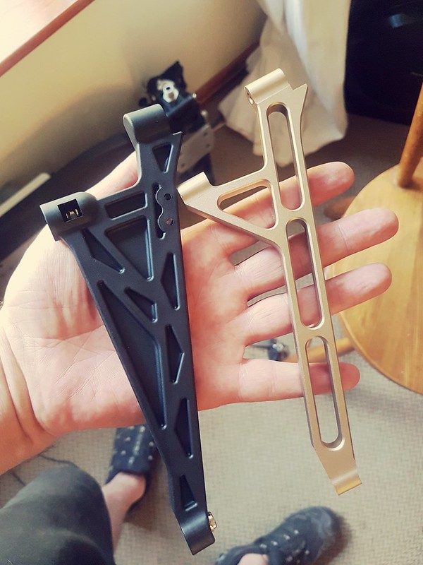

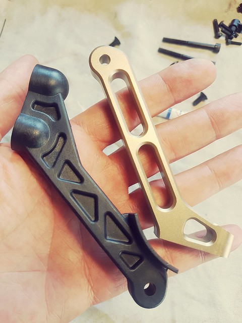

there was some other stuff in the box. TLR top/front brace front and back chassis brace. A losi aluminum servo saver

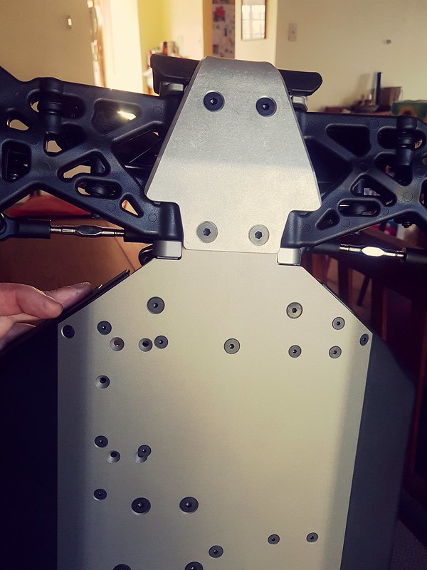

arm bartalone skid plates front and back. oh i also ordered the TLR dual alu servo tray , shockwears in black all round
and a killer bee killswitch and a rock amour brake/throttle brace and a vertigo center diff brace (y)

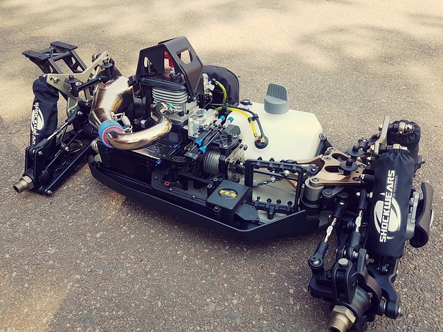

here are a few pics with some of the stuff on, quite chuffed with my new bits:p

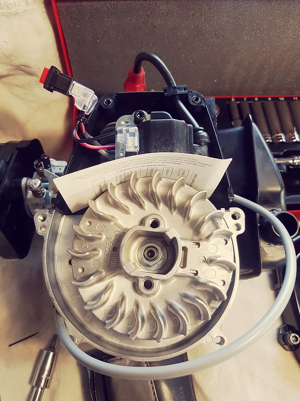

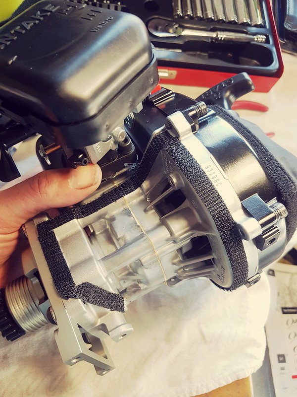

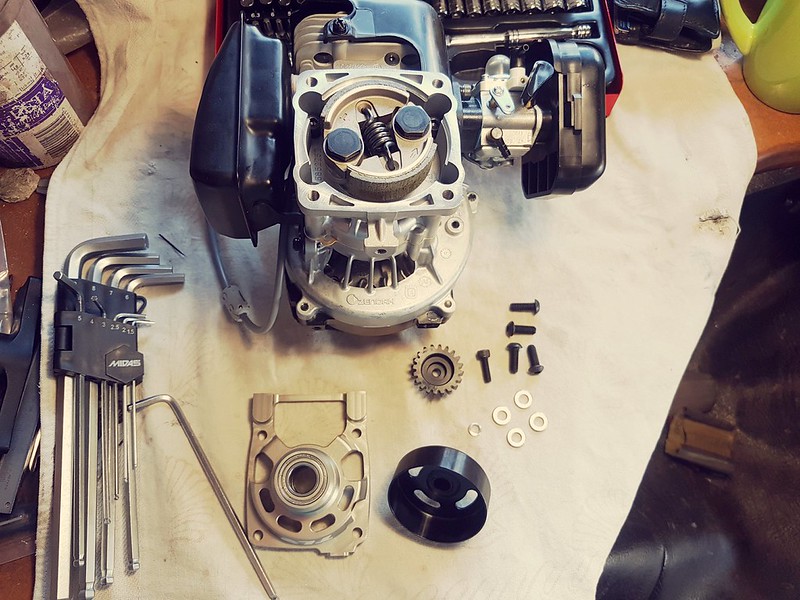

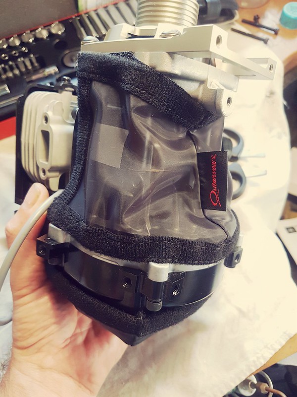

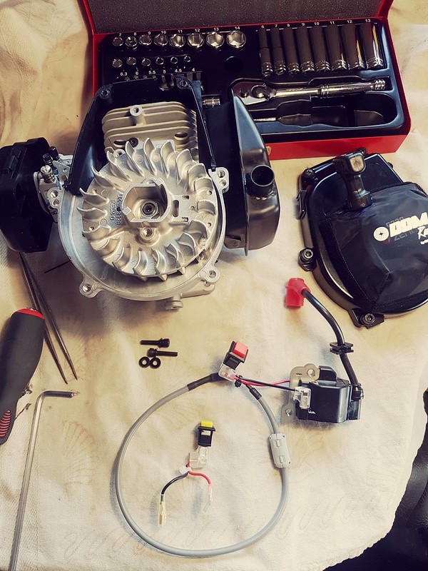

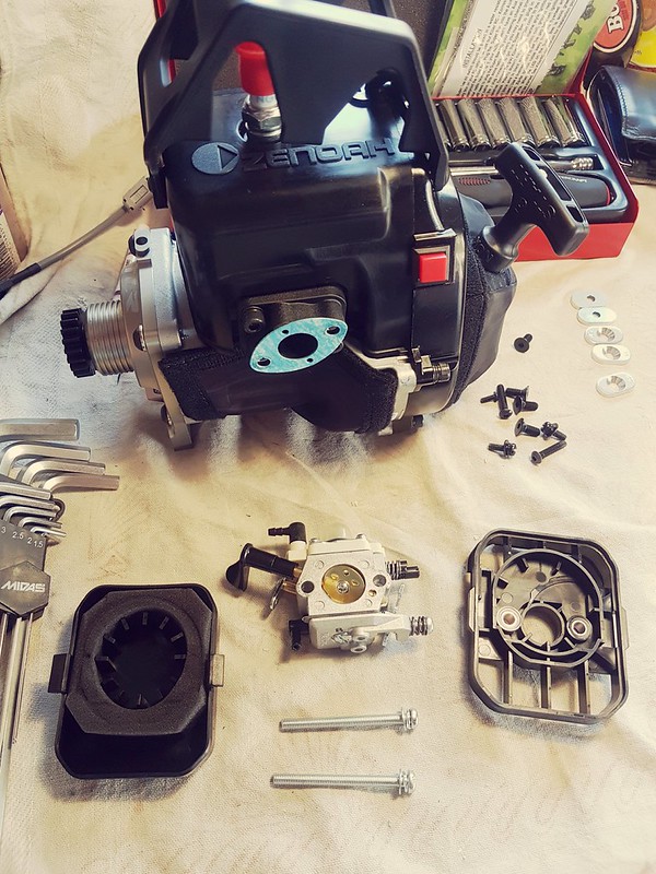

got my G320 put the killer bee kill switch in......first i routed the cable out the exhaust port side.......getting all the wires to sit nice so as the covers go back nice was fiddly to be nice about it. put the clutch bell and carrier on..... noticed pinion gear had a slight wobble but only slightly figured must be the shaft off the clutch bell. then did the carb filter. put the motor in noticed i did not like the way the killer bee cable was so close to the rear dog and guess what .....did not connect the fuel lines:banghead::arghh::finger::mad:
so took out the motor change the killer cable direction connected the fuel lines and then the linkage to the carb was not right!!!!!! F#$K!!! SAKE:banghead::dead: all out again landed up trimming small bit of the motor shroud . all back again YAY susses! put on the bart pipe called it quits for the day. here are some pics of the fun

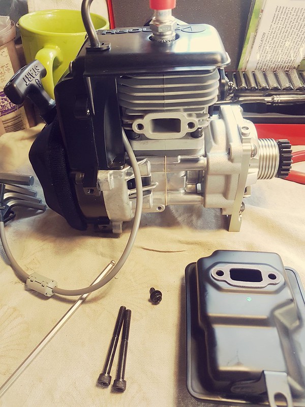

the crank case cover went on next
had to take off the can to fit it
next was the motor here i have the 5B upside down so i can bolt it in. it uses locators to center the motor and align the gears

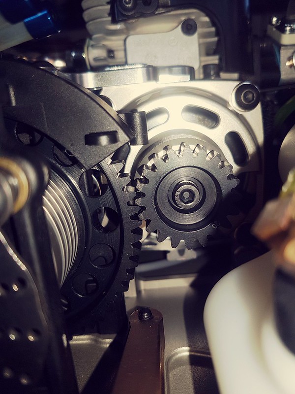

here is a pic of the gear mesh thought it could be closer

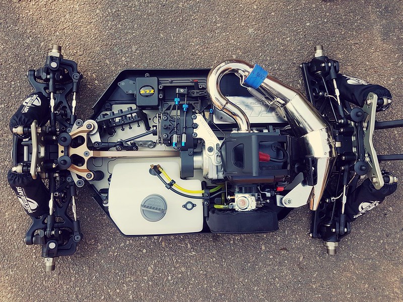

here are some with the bart pipe

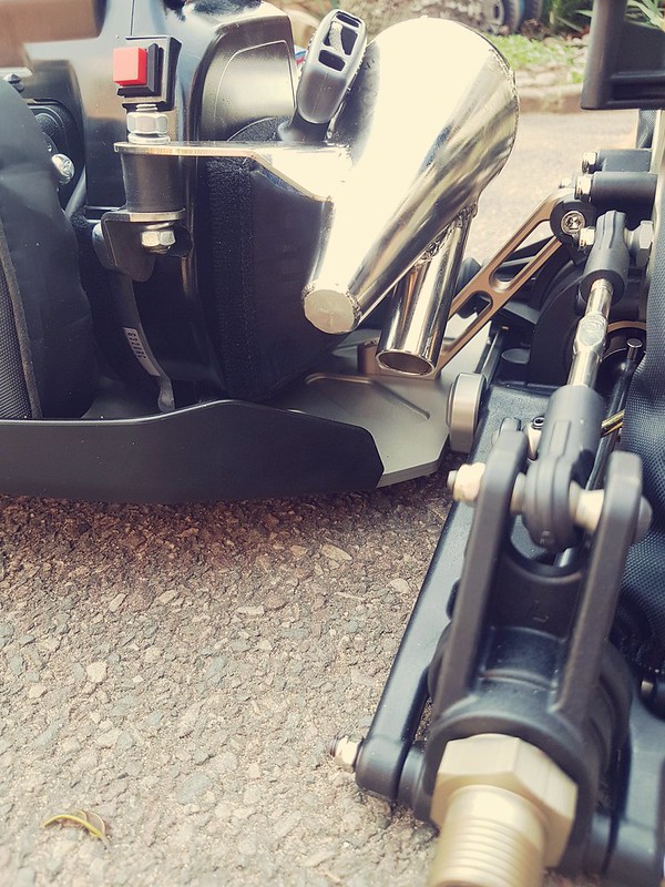

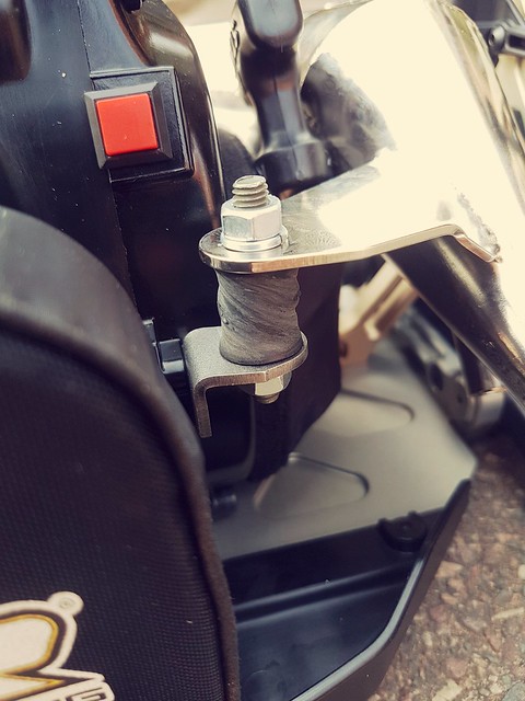

got the body out to see if the exhaust is touching and it dose only in one place.....were im pointing with
my finger. thought if i trim the exhaust rear rubber mout it may fix the problem
may put an extra bit of hose on the end just to get it out the body
The bart pipe.....besides them not being in stock when i bought everything....you are going to have to take the pipe and or motor and pipe off the truck in order to access the battery box....but you shouldnt have to get in there a whole lot...unless you charge the battery outside the truck (another argunent topic). If so, that pipe is coming off everytime you want to charge the battery....not that big of a deal though.....
The exit on the bart pipe looks like it sits pretty high??? Might spray all over the rear arm and turnbuckle??? Shouldnt be too much of an issue...would some exhuast tubing help route that away from the arm?
