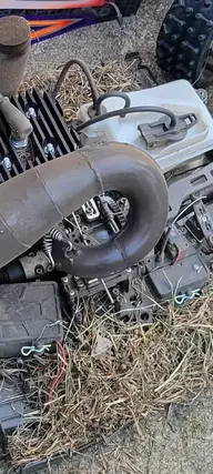

I'm going to look for that plate no wonder when I was searching for pictures of the setup kept seeing the throttle servo facing differently. ThanksYou are in the wrong location. I think where you are installed is for an added brake servo if needed. 2 ways of doing it but 1 will require parts not included.
There is an adapter plate that goes across the larger servo opening for standard size servos. The larger opening is for Hitec larger servos(not the 840/845 but slightly smaller ones…can't remember the #). The adapter plate should be in your bag of goodies that come with the kit. You can kinda see it below.
The other you have to order the alloy plate to install.
